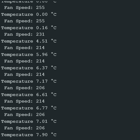

trying to make a temperature controlled fan using lm35 as the sensor
Screenshot 2024-05-21 140118
lm35 temperature sensor reading is wrong and i think the problem is with my code ( I used Chatgpt to write it and edited it to try and fix it )

Which arduino are you using?
Arduino uno
This tutorial explains how to connect the LM35 and how to read the temperature.
so from what i understand the formula i used to convert the reading to temp was wrong ,
tried to fix now it alternates between displaying unstable temperature for a few seconds and returning to 0 for another few seconds . and the fan speed is suddenly exceeding max speed

Check your connections.
Sometimes breadboard connections can be loose or be internment.
Make sure the connections are tight.
checked the connections they're all tight , tried to rewire on another breadboard the issue stayed the same .
There have been quite a few fake LM35 on the market.
Where did you buy them and what was the cost?
Try the code without the fan connected, see if its stable
tried a different sensor and it works now thanks
Guess the other one was bad.
Glad you got it to work
Have a nice daty
This is code for a 3.3volt processor with a 12-bit A/D.
So the code is not compatible with an Uno R3.
Leo..
