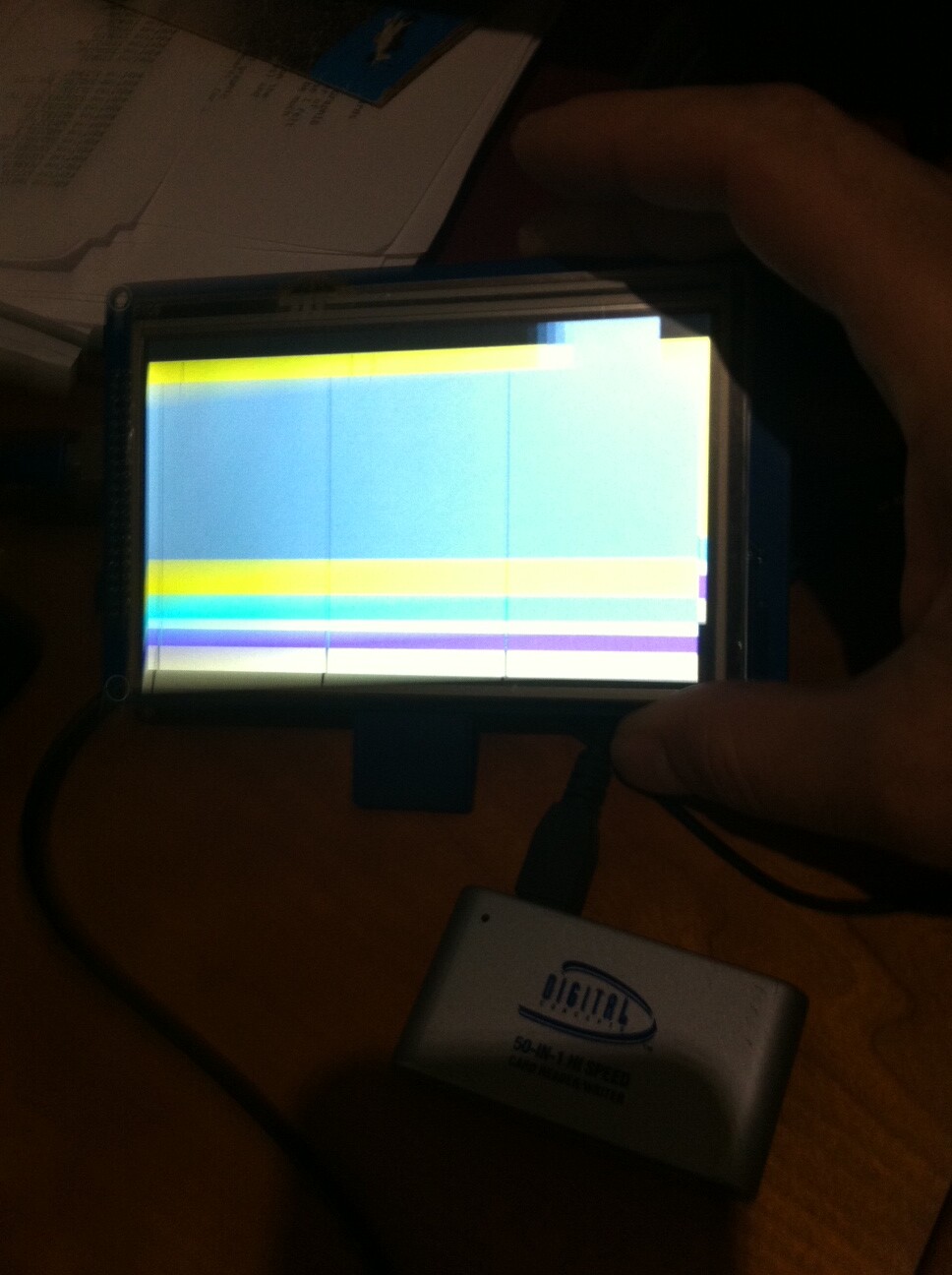

I've managed to write/draw and use the touch functions well, but cant get the demo to load images/fonts/icons from the flash IC.
The demo file supplied by Coldtears have two parts, one based on Henning Karlsen's UTFT library, works well, but the other part of the demo, loading fonts and icons from the IC , fail, and I get only colored bars.
Can somone help me through?
Thanks in advance

Can you post a screendump of what you see?
Which IDE version are you using , which UFTF version.
Did you already try to upload custom icons/fonts/.... or not (just to know if the display FLASH still has its factory icons/fonts)?

I use IDE 1.5.6-r2
I tried using two UTFT versions.
The first, downloaded from Henning Karlsen (the latest version in his site). With this, the I could not see the flash IC content in the demos (got the color bars right, then, instead of fonts/icons that should have appeared, I got just varying color bars, and next, a continuation with graphics, based on Henning Karlsen UTFT library.

Now, I found that Coldtears set a UTFT library adjusted for Mega (libraries for MEGA) which has 3 folders inside (Importer, sdFAT and UTFT). Tried this UTFT library, but with this one: 1) the screen flickers 2) again cant see the flash icons etc.
Then I wondered if I can connect at all with the flash IC, so I tried the demos on the spiFlash library, and managed to see that using the SPIflash_ChipTest, I managed to erase all the flash IC content :frowning:
That told me at least that the chip works.
Now, I tried the Importer demo, which should import images from the SD. I bought a 2GB SD card, formatted it to FAT16, and loaded it with a 0.CTE file and ran it.

While with the original UTFT library there were many compilation errors (I compared the UTFT.h files on both versions, and the original version lacks many arguments appearing in the Coldtears version). So I used the Coldtear UTFT version for Mega, and compilation went well, however running it results only in changing color rows.

Can you tell me which libraries you use?
I'm using the same sketch as the one you listed, but I am using IDE 1.0.5.
I don't know anymore why but to get it work I had to make a separate IDE version 1.0.5 with only the SdFat and UFTF_MEGA libraries; I only use this IDE to import images to flash and nothing else.
If the upload goes OK, the image that you upload to flash should be displayed after the upload to flash is finished.
Do you see that image or anything else ?
Could you post a picture of what you see on the screen ?
You will need patience, it took me 3 days to find out how it works.
OK.
Tried what you suggested, but did not work. I created a new IDE 1.05, put in Arduino/libraries the following from "libraries fro MEGA" : Importer, sdFAt, UTFT.
Nothing changed. Tried also to use the original sdFAT (Henning Karlsen), but all I get is this screen:
Any other options to import a 700x300 pixels image to the screen? It has to be written only once in the beginning of program.
Thanks again
