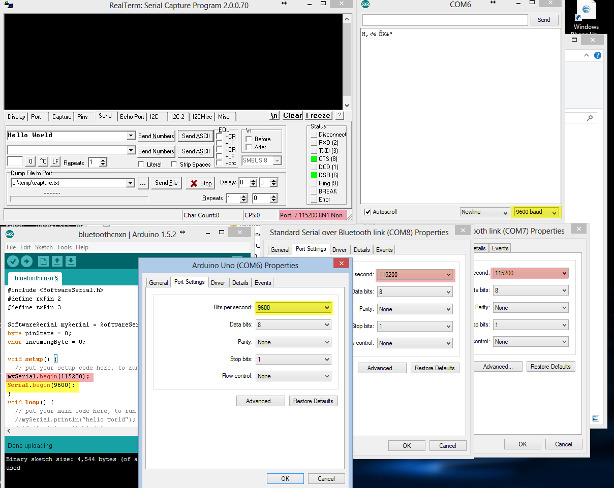

Check your setings on Realterm do they match the ones used by serial? (stop bits/parity) and try droping the baud reate strat out at 9600 and work up!.
Mark
Dropped everything to 9600. Didn't work.
But to prove i'm not crazy.. Here's the settings of all ports.. CTS and DSR solid as a rock.
Post a screenshot of the "Port" tab of RealTerm.
Also, you might try the simpler case of just using RealTerm against the programming port to ensure you at least have everything talking properly first and to eliminate the blue tooth serial comms as an issue.
Send it Hello World and have Arduino kick back "OK" or enable the pin 13 LED if it successfully compares what it received to the string it expected.
Here ya go
BTW, I already tested it the other way, doing hello world and painted the terminal in realterm as its supposed to. It's when I send data from realterm, thru the bluetooth and try to read it thru serial monitor that it's getting corrupt.
So it looks like your blue-tooth port is COM 8 and I'm guessing the Arduino programming port is on COM 7? Earlier post shows it on COM 6.
When you pair a bluetooth module, it creates 2 ports. You are supposed to use the lower one. Don't ask me why, thats just the way it is.

exedor,
While it may not have seemed as if I was understanding you, I was actually a little bit ahead of you as far as trouble shooting goes. I understood what you were getting at, and it got me poking around a bit more. Thank you for your code and help. The code helped me more than anything to try and figure out what was going on. It made me realize that I needed to test it beyond a blinking light, and start printing it back out to both windows to get a full test.
So I've concluded that the communications on the BT module are all jacked up. The internal communications on the bluetooth were what was jacked up. This prompted me to just go in and reset it to run 57600. I'm not 100% sure of the baud rate on the module.
