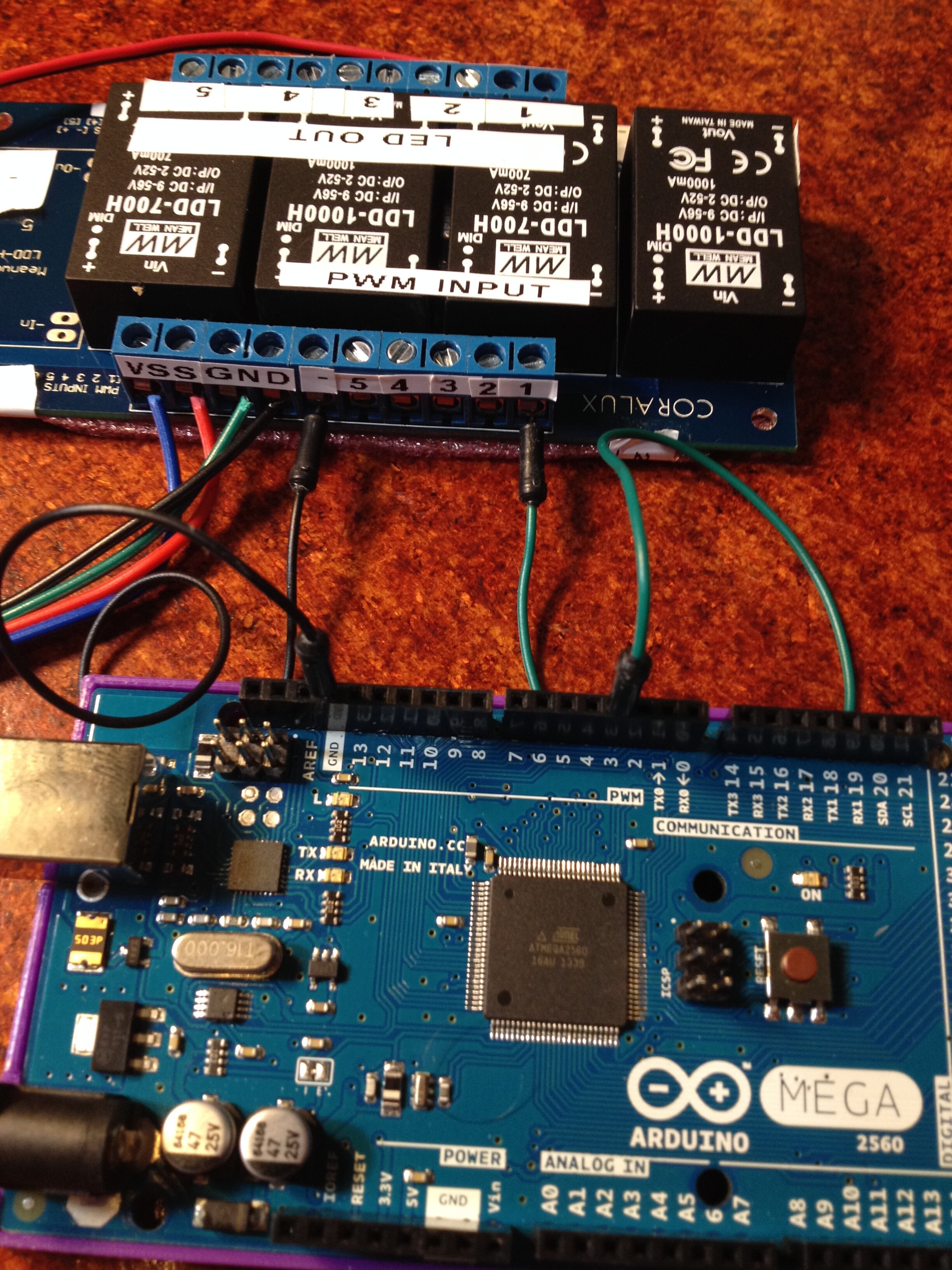

I'm having trouble controlling the LDD drivers with the PWM signal. I have a Mega 2560 R3, Coralux x5 board and Meanwell LDDs installed. When the pin is set to zero I get no voltage out, but when anything greater than zero is set, the voltage is 46.7. Which is what the MW SE-350-48 PS is supplying. If I check the voltage coming from pin 3 it is inline with the the value set.
I read other places that is would be a grounding issue, but I've grounded everything. Ground from Mega to the ground from PS.
Any help or guidance would be VERY helpful.
Here is picture of the setup.
Problem solved…
Maybe cautious isn't always a good thing.
I strung together 8 small LEDs and a 10K resistor. Set my brightness to 1, 2, 3, 4 on the channels, and I get 14.0, 14.2, 14.6 and 14.8 at each pin. So the LDD just needs to complete a circuit before it will work.
Better to be cautious than blow a RapidLED Aurora puck. But I already miss the 8 hours I've been trying to figure this out.
