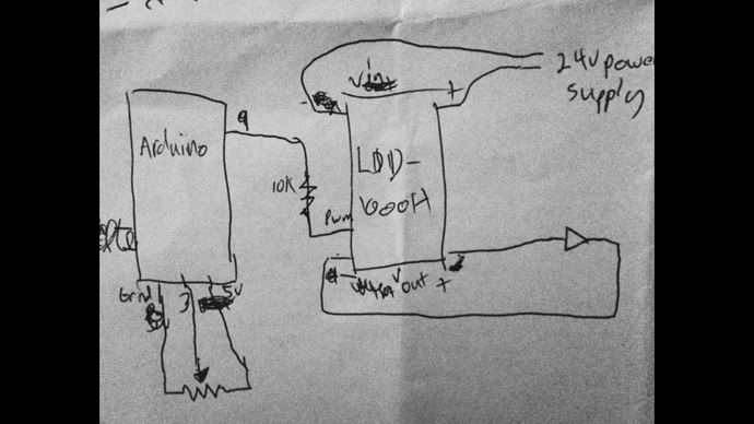

I'm currently working on an LED light for my reef aquarium, using Mean Well LDD-H DC-DC drivers. I was planning on buying an off the shelf controller, but as I'm short on cash I am trying to control my light using analog/0-10v input via an Arduino board.
I found this simple sketch that should do the basic conversion of analog to pwm: analogWrite() - Arduino Reference

My problem is that it's not working as I expected it to do. The LEDS don't dim at all and the just blink. Can anyone point me on the direction of why things aren't working? Or if anyone has a sketch that will accomplish my goal, I'd love to see that too.

The mean well is a LDD-1000h, my setup uses 2x 1000h & 2x 700h for 4 total channels but I'm just trying to get 1 channel to work first.
Excuse the crude schematic, I know the pin layouts are not true to form but it should be understandable(if not I'll redraw it).
Wvmarle: the pwm output goes to the LDD driver that then outputs the voltage for the LEDs.
LDD drivers can be PWM dimmed with 5volt.
Just connect the DIM input (and ground) to the Arduino.
Need to see a full diagram, with supply (voltage/current) and number of LEDs in a string, etc.

Ground wire is needed between Arduino and LDD supply(-).
The 10k resistor might prevent dimming to fully off.
Remove (use a direct connection) if this is a problem.
Can use max six LEDs in a string on a 24volt supply.
Leo..

You might be trying but that is not what you are doing.
You have no smoothing capacitor on the PWM output and no driver to 10V, so you are not feeding the controller with a 0 to 10V analogue signal. You are feeding it with a 0 to 5V PWM signal.
Don't know where this 0-10volt comes from.
The LDD driver OP linked to has an input range from 0-6volt.
And can be dimmed with 5volt PWM.
Switch points are 0.8volt and 2.5volt, so even ok with 3.3volt logic.
It seems that it didn't work, because OP didn't connect grounds.
Leo..

One sees the MEAN WELL PWM dimming 10V mythology on many forums, again and again, year after year.
MEAN WELL drivers like these boost drivers or those buck drivers specify the PWM voltage to be within a 2-10V or 2,5-6V range, so indeed Wawa is correct: What an Arduino or compatible μc can supply from an output pin is all that's needed for PWM dimming.

Wawa, which negative terminal on the LDD should the ground from Arduino be connected to - should it be the input side or the output side of the LDD?
Thanks.
--equipoise
Never used an LDD. I make my own LED drivers.
But I suppose Vin (power supply) ground must be shared with Arduino ground.
Leo..
