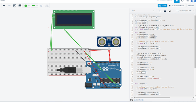

hi, i'm trying to get this project to work on thinkercad... GitHub - Abdelrahman1810/People-Counter-Arduino-UltrasonicSensors: This project is a simple people-counting system that uses ultrasonic sensor, an Arduino board, and an LCD display to count the number of people passing through a specific location. The system is designed to be easy to set up and use, making it a great solution for a variety of applications such as retail stores, libraries, museums, and more.
I have connected it like in the project description, but i dont get anything on the lcd screen (im very noob)

here it is: `#include <Wire.h>
LiquidCrystal_I2C lcd(0x27,20,1);
#define trig 6
#define echo 7
int t_puls = 0, distance = 0, No_people = 0;
int initial_distance = 400;
const int sound_speed = 57; // you can change it depend on the weather
pinMode(trig, OUTPUT);
pinMode(echo, INPUT);
// making puls with width 10µs to Trigger
for(int i=0; i<3; i++)
delayMicroseconds(i*5);
digitalWrite(trig, i%2);
t_puls = pulseIn(echo, HIGH);
distance = t_puls / sound_speed;
initial_distance = distance;
Serial.println(initial_distance);
lcd.begin(16, 2);
lcd.backlight();
lcd.setCursor(5,0);
lcd.print("Hello");
delay(1500);
lcd.clear();
lcd.setCursor(2,1);
lcd.print("Person passed");
delay(100);
if(distance <= initial_distance - 30) // you can change distance 30 depend on the position of the sensor
while(distance != initial_distance)
delay(50);
No_people++;
lcd.setCursor(8,0);
lcd.print(No_people);
i dont get annything on serial monitor :frowning:
did you click on the sensor to move the 'object' once you started the simulation?
are you sure the LCD you selected is the I2C type?

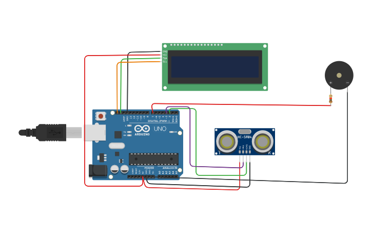

maybe try this one... its already all wire up and works! :wink:
you can then check what the difference with yours!
hope that helps....
