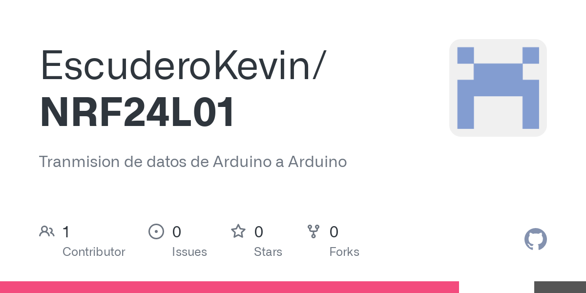

I think this is the library you need:
oqibidipo:
GitHub - EscuderoKevin/NRF24L01: Tranmision de datos de Arduino a Arduino
Looks like it, but minimal examples, poor (non-existant) documentation, a foreign language. If I were Guitartexan, I'd stick with the "RF24" library and learn how to use it.
