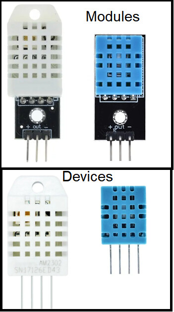

So basically I was following a tutorial and it uses a pull-off resistor, and it makes sense to me why he used it, so I started building my circuit and programming it, it works fine, but when I remove the 10ku resistor the circuits continue and the arduino can read values, so resistor makes no difference, but why?
One possible explanation: Is that the sensor always allow current to flow in it, So the pin 2 always send some voltage to the arduino, then he can read and dont go crazy.

Are you using modules or device?
first image DTH11, 3 pins
This kind of modules, (first image), has restores built into the PCB.
Se the next images.
Im gonna send you a picture.
What does that means?
What's written on the piece I marked in red?
And I couldn't read.
the chip have a number, 512, on the side (on the board) R1, and a "S" in the front
OK. 512 means = 5 1 zero 2 zeros = a resistor of 5000 Ohms = 5K.

Correct 5 1 2 zeros = a resistor of 5100 Ohms = 5K1.

Actually 5.1K or 5100

So that resistor does the job of the pull off resistor and so i dont need to add one?
Correct.
