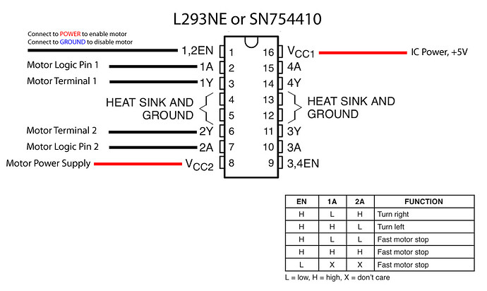

I have a simple project that the following pins of my arduino UNO are connected to a L293D IC and would like to receive a simple code that the dc motor can turn to right and left by dialing 1 or 2 or using an App and also the motor working time can be set for 5000 mili seconds and then off
int motorPin1 = 3; // pin 2 on L293D IC
int motorPin2 = 4; // pin 7 on L293D IC
int enablePin = 5; // pin 1 on L293D IC

Have you so far written a sketch to at least run the motor one way then the other without any commands? Seems the way the forum works if you have to bring something first: you are unlikely to get a turnkey solution.
There must be lots of examples of how to drive a motor with an L293: all you need is to make the enable pin high and then the other two pins high/low for one direction and low/high for the other.

Well that's impossible without the code you already have, since nobody would know where to put the new lines to do the 5000ms and turn it off.
Here's a wild guess. At some point there will be lines like:
digitalWrite(motorPin1, HIGH);  //for one direction
digitalWrite(motorPin2, LOW);
and
digitalWrite(motorPin1, LOW);  //for the other direction
digitalWrite(motorPin2, HIGH);
A quick and dirty way to do what you want is to use delay(), followed by the lines to stop the motor.
So immediately after each of the 2 sets of lines I just showed, stick these in:
delay(5000);
digitalWrite(motorPin1, LOW);  //for stop
