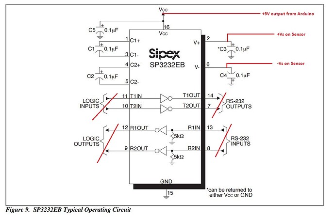

Thanks to the both of you for your help. Can you please comment on my schematic? I couldn't find the MAX 232, but I did find something similar the SIPEX SP3232 - datasheet

Ok but be aware that the current draw you can take is in the order of a few mA.

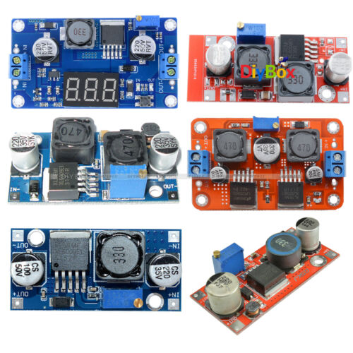

OK thanks for the feedback, appreciated. Do you know where I can find a "voltage mirror" or happen to have a specific part number or part number in mind?

I use these.
Awesome, thanks!
