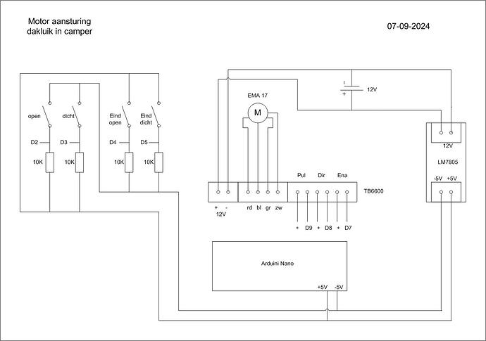

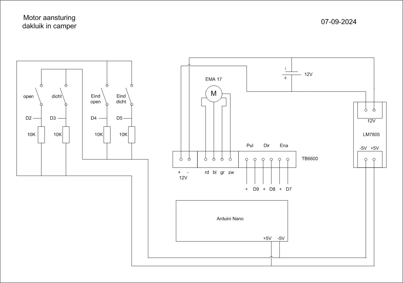

picture of schematics
The code is working, the switches do what they are supposed to do.
The motor is spinning as well, but very slow and with a lot of noise. That is the problem.
The Arduino Stepper library will not work correctly with step/dir drives, seems you have a mix of Arduino Stepper library code and AccelStepper library code.
Not related to the malfunction you encounter but is there any reason some switches are connected to ground and use pull-ups and others are connected to 5V and use pull-downs ?
I think you can connect them all to ground (the -5V pin on your drawing should actually be named GND or 0V as it is ground) and use the µC internal pullups :

I have to use the pull-ups, because I use the Pushbutton library vor debouncing. That library only works with push-ups. And indeed, not related to the malfunction.

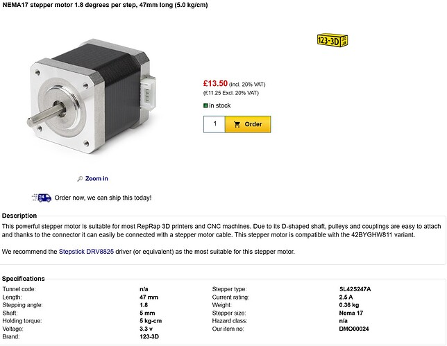

Usually a DRV8825 is sufficent to drive a NEMA17. Did you set the current properly? As @sterretje already pointed out, NEMA17 only tells about the mechanics ( size of mounting/front plate ), not anything about the electrical specification. So please post a link to the specs of the motor.
Seems to be a little too much for a typical NEMA17, but as already mentioned we need the electrical specs of the motor to be sure.
The stepper.h isn't a suitable library for a step/dir driver. The motor only runs with 1/4 of the set speed. And all calls are blocking while the stepper moves.
You could try the MobaTools library.
Steppers are not really running quiet - especially in full step. If the current isn't set properly, it may be even worse.
A link to the specs
https://www.phidgets.com/productfiles/3303/3303_0/Documentation/3303_0_Datasheet.pdf

Why again a new driver? That doesn't help. And the easydriver is by far too weak for your stepper. Regarding the datasheet the stepper is rated for a coil current of 2.5A. That's a lot for a NEMA17 stepper. From all drivers you tried so far, the TB6600 is the only one that can provide that much current.
Did you try your simple test- sketch with the TB6600?
What about the PSU you use? Can it provide the needed power? The stepper needs 3.3Vx2.5A = 8,25W per coil or 16.5W overall. And you must take into account the losses of the driver and some headroom. So your PSU should be able to provide at least 30W.
The problem is the weak easydriver, not the motor. How did you adjust the current? The easydriver is rated for a max of 0.7A, which is much too less for your stepper.
