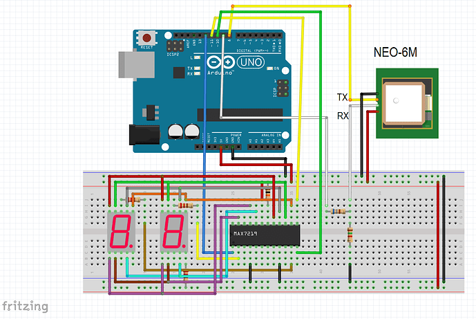

Hello friends and good evening :slight_smile: .
I am building a back to the future style speedometer using an Arduino Uno and a GPS module Neo-6m to drive, through a MAX7219, two common cathode seven-segment displays for speed reading. The code seems to work correctly as far as the display is concerned but unfortunately there is a huge delay in the speed data output which is sometimes not even received by moving the gps module, despite having raised the output rate of the Neo-6m At 10Hz and using the NeoGPS library.

And this is the wiring schematic:
Maybe there's some interrupt going on but i have no idea of what could cause this issue. Any answer or ideas are highly appreciated.

With your code I can clearly see the NMEA sentences, they are not transmitted at 10Hz but at 1Hz.
The delay in the speed value does not seem to be in the tx, that is, from when I move the gps to when the arduino receives the movement, seconds pass, but the transmission takes place correctly at 10Hz.
This are the Sentences:
You are getting samples once per second and averaging four of them. If the speed increases by 1 you will need 3 samples before the displayed average increases by 1.
What happens if you take out the averaging?
With no averaging i get a wandering speed, even when not moving sometimes it goes up to 4-5 and still when moving the module the update is not istantaneous.
Spurious speeds are an inherent characteristic of the GPS module as far as I can tell. It's in the nature of the entire system that the computed location will move around even if you are stationary. Nothing we can do about it. I don't know if averaging helps. If you take 4 readings and one is way out, then it shouldn't be included in the averaging.
I use a Neo-6M and it gives great performance at driving speeds but sometimes crazy speeds when stopped, say 126 kph. I ignore it. You could filter out spurious values in your code, say any that jump more than 10% from the previous. Or just don't worry about it.
Feed the NMEA sentences into the u-center software from u-blox. There's a great deal to be learned from using this software. You can see graphically how your position jumps around.
It s a pity that the forum does not have a section devoted to GPS. We keep rehashing the same topics.
Maybe set a treshold under low values can help that, the GPS is anyway not so precise especially on low speeds. I tried it 10 minutes ago in my car and works quite well and the response time is acceptable, maybe the problem was indeed the averaging code slowing down the output.
