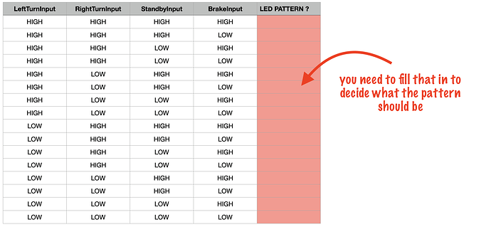

do you understand that you test all the buttons in a row, so some clear() calls are made
im wanna is simple..
just led is turn on when toggle on and off when toggle off
not blinking when toggle is on
sorry my english is everywhere :sweat_smile:
what you mean is i need to divide all the button?
the code tests LeftTurnInput, if it's LOW it shuts everything off
then the code tests RightTurnInput, if it's HIGH, it lights a specific pattern
but then you keep testing so if StandbyIn is LOW, you turn everything off again
➜ hence the blinking you see
makes sense?
you want to asses the global status of all the buttons and decide what to do only once.
you have 4 switches, so 16 combinations !

You have 16 possible combinations. As @J-M-L has suggested, fill in the table. Determine how many are unique. Read the 4 inputs, determine a "state", decide what the LED condition should be in each state, then do one strip.show(). Otherwise, your repetitive actions in non-active states are clobbering your previous settings for active states(those else clauses that do the clearing). Here's the order:
//read switches, determine switch state; at a minimum, you'll need five, one for each switch plus a "none"
//switch case(switchstate)  (the following cases are one possibility)
    //left
    //right
    //brake
    //standby
    //none
    //default case (could handle all the 'unusual' states, with two or more inputs asserted)
//strip.show(), done once when all is set up
Remember, it doesn't matter that some of the cases, e.g. Left AND Right, aren't logically possible, you really still should have a default that handles that possibility, because your
switch can be set that way.

      strip.setPixelColor (0, 0, 250, 0);
      strip.setPixelColor (1, 0, 250, 0);
      strip.setPixelColor (2, 0, 250, 0);
      strip.setPixelColor (3, 0, 250, 0);
      strip.show();
    case 0b0010: // only rightTurnState
      strip.show()
    case 0b0011: // both leftTurnState and rightTurnState
      strip.show();
    // ......... do all the other possibilities
    case 0b0111:
      strip.setPixelColor (0, 250, 0, 0);
      strip.setPixelColor (3, 250, 0, 0);
      strip.show();
    case 0b1111:  // all of them
      strip.show();
basically the same code you have in all the tests assigned to the right case
this way you read the status of the pins only once in a loop
And, it's obvious what section of code you have to modify when you want to add something to only one state. No parsing up and down the if-then-else logic chain hoping to find the one place you want to add that one little statement to, for example, turn on a dashboard light for just the Brake state.
C
whoa thx @J-M-L for more detailed explanation with example
@camsysca now i get it how its work thx for more explanation to.. my code is more simple now
