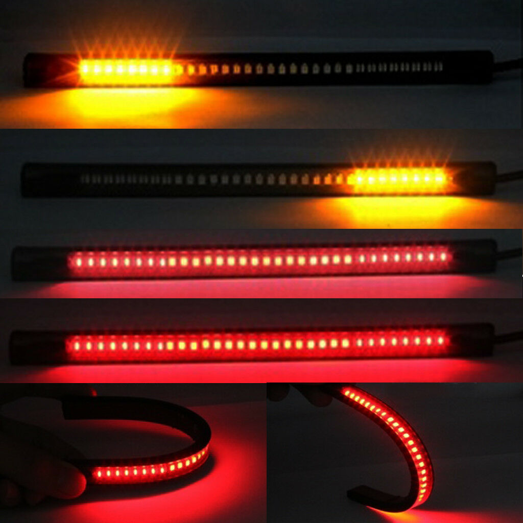

Hi all,
I have this program that works 95% but need help with the code a bit
this is a turn signal and brake light and running lights. the following scenario I am trying to achieve is
15 pixels :
8 for left turn
8 for right turn
brake light all on if alone
running light on dimmed by default
when I press the brakes it overrides the running lights brighter then back to running lights once foot off pedal.
when I apply turn signal 8 on - 7 off ,unless I press the brakes or vice versa to have
8 signal lights on and the rest red steady.
hope it makes sense.
