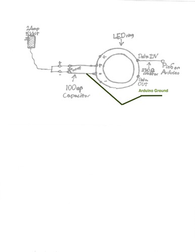

I can't see the ground of the Neopixel power supply is being connected to the ground of the Arduino. + what R P says about using 24 not 23.
Three resistors: 1K, 10K and 330R? Its hard to see where their legs go. What are the 1K and 10K for?
Grumpy_Mike:
The ground of the power supply is connected to the outlet, and to the ground of the ring itself.
I did 23 because I wanted to see if I got different results. Nope.
PaulRB:
The other resistors are there to reduce power of signal more. One resistor is the pull down, and the other two are in series to the input signal on the ring.
Do I need the data out connected to ground? That might help...

You need to connect the Arduino's ground to the ground if the ring as well. Form that description you have not.
Just one resistor 470R, no pull up or down.

ok, I took out the pull down, but why should I connect GND on the ring to GND on the arduino as well?
You need a return path for electrons to travel.
yes, but GND on the ring is already connected to a ground. why two?
draw a representative wiring diagram to show us the way things now.
Repet:
Because ground is not common by default you have to make it common.
Why ask for help if you are only going to argue?
Do you think that after 50 years in electronics I make these things up. Just connect the dam wires together.
Thing is, without adequate description (perfectly focussed photograph might suit) we really have no idea at all what he means when he says "GND on the ring is already connected to a ground".
here is a diagram...
Do I need to redraw it?
Wiring Diagram.pdf (140 KB)
Look either connect the ground to the Arduino ground or stop moaning it doesn't work correctly.
