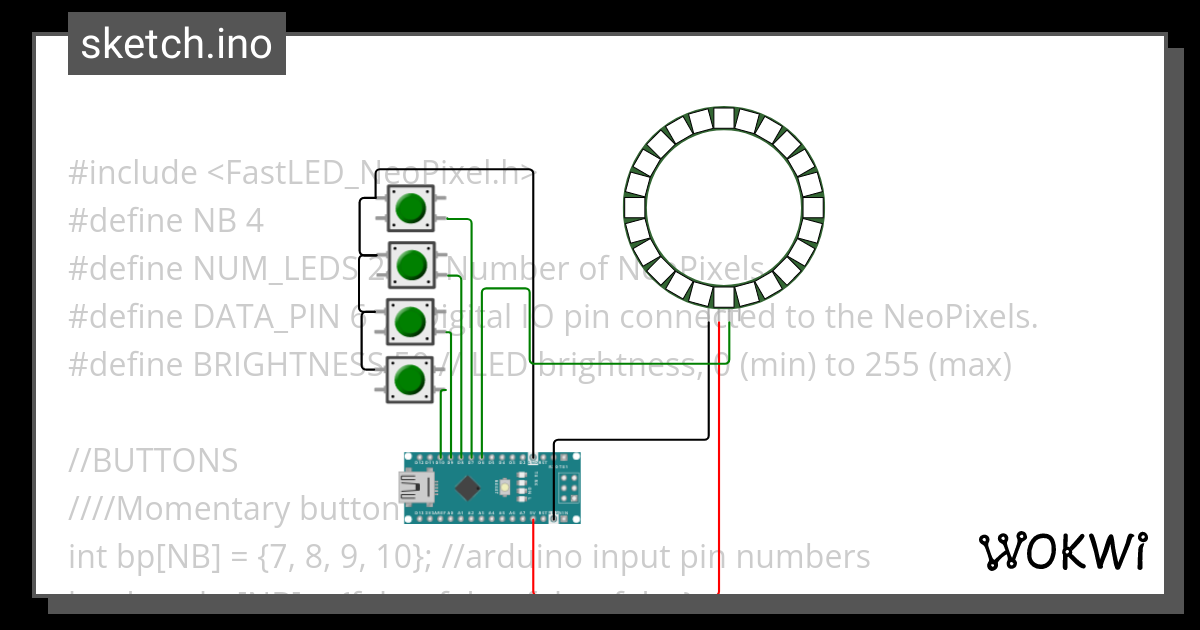

I'm fairly certain I need to put in some code such as:
const byte BUTTON_PINS[] = {2, 3, 4, 5};
But how does this tie into the loop?
perhaps you wanted to say "inputs" instead of outputs?
Yes, In a way I did. I edited the post as such. I meant to say the multiple outputs as inputs to the Nano LED controller.
Your answer is still not clear. As I understand it, you have several inputs (buttons), depending on which you want to show different patterns on the led.
What is the "led controller" - you mean your arduino board or external device?
I have multiple Arduino Uno's controlling their own separate puzzle games and one Arduino Nano controlling the LEDS. Upon completion of each puzzle, I want the arduino of that game to output a signal either by an output pin or it's contact closure (preferably by the contact itself so as to avoid ground issues) The Arduino Nano would receive those signals through an input pin and that will decide which pattern to show. This should be instantaneous and interrupt whichever pattern loop it is currently displaying.
And what is your problem with it?
I'm getting a bit lost on how to call out the different patterns using a simple If pin high then . Am I overthinking this?
I suppose that you have a several such pins - one from the each of Uno ?
Each of the respective Uno's can be given their own output pin, sure. For a standalone I am experimenting with a simple "button" for the time being.
My main question is "is this as simple as calling out an input pin, then reading that input pin with an 'if' and a 'then' statement?
The answer is perhaps "yes" if you know which pattern should be shown for each combination of input pin states.
Yes as I understand what you are doing.
If you can make your code work with seven pushbuttons on input lines on the Ring Arduino,
those seven inputs can come from anywhere, as long as the voltage is between 0 and Vcc (5 or 3,3 volts often).
The Ring Arduino cannot tell and could not care from where the inputs come.
There may some practical issues, at the very least you must know that there will need to be a common ground.
Someone will point out that you could use optoisolators, and need no common ground.
How far away are the satellite Arduinos?

Getting there. Still have a few bugs to kick out....or I am completely going down the wrong rabbit hole altogether.
#define NB 4
#define PIXEL_COUNT 45  // Number of NeoPixels
#define PIXEL_PIN    6  // Digital IO pin connected to the NeoPixels.
//BUTTONS
////Momentary button vars
int bp[NB] = {7, 8, 9, 10}; //arduino input pin numbers
boolean bg[NB] = {false, false, false, false};
//Toggle button vars
int btv[NB] = {0, 0, 0, 0};
int btamt[NB] = {2, 2, 2, 2};;
boolean btg[NB] = {true, true, true, true};
Adafruit_NeoPixel strip(PIXEL_COUNT, PIXEL_PIN, NEO_GRB + NEO_KHZ800);
  for (int i = 0; i < NB; i++) pinMode(bp[i], INPUT_PULLUP);
  strip.begin();           // INITIALIZE NeoPixel strip object (REQUIRED)
  strip.show();            // Turn OFF all pixels ASAP
  strip.setBrightness(200); // Set BRIGHTNESS (max = 255)
  //BUTTONS
  for (int i = 0; i < NB; i++) {
    if ( digitalRead(bp[i]) == LOW) { //button pushed

I'm on the hot sand under an umbrella and wokwi isn't terribly good on my tablet but…
...it looks like you are testing using pushbutton proxies for the signals which are going to come from the satellite puzzle Arduinos.
And that seems to be working.
The only thing that may not be a flaw but is certainly true is that the system is incapable of interrupting an effect, and blind to changes on the input lines during.
So what? Only you can say that's no problem, I can easily see that it might not be.
About the whole thing, dude you having way too much fun and if you are also getting paid for this I am sorry to only be able to enjoy your success vicariously.
Generally we like to make ppl (!) do everything on one board, as can often be the case. Noobs alla time think throwing boards at a problem is better/easier than learning how to code.
In this case of a very thin interface between the various part, that is to say one digital line with an infrequently changing signal, you are probably better off with multiple boards, easier for all the reasons I think you stated.
Also easy to test, both the display thing and the satellites, either with pushbutton as in your wokwi, or an LED for the satellites.
IRL there may be some excitement when these units are deployed all over the room, easily extinguished excitement for sure, and a bridge to cross when the time comes. Above my pay grade, TBH, but simple as far as I have seen to solve issues.
I'll take a close look at the code in the lab where we have some real computers.
But if it works, proceed. You did mention some hiccups, elaborate if you can't hold your breath long enough for them to go away.

More Progress, I have all the buttons working, rid the program of some extraneous code and organized it somewhat to what I want the order to be. I also switched to the FASTLED protocol to see if I like it better; meh! a bit more controllable with the parameters, but almost the same. We will see.
The only thing, and I think Alto reffered to it
And that may not be a problem. I am going to try to explain the flow I want to work and then what it is doing I don't seem to like.
FLOW: upon startup a looping colorwipe of four colors - red, blue, green and orange. When a button is pressed or a relay is kicked, what have you, lets say input realized, it goes into another pattern, like Red and Blue Marquee (simulated alarm) and then back to the original colorwipe.
ACTUAL FLOW: Upon startup, there is a Colorwipe happening that cycles through four times, once for each button to realize they are not pushed, then a pause until a button is pressed. Then a color cycle until the button is released then once through the original colorwipe and pause.
I want the original colorwipe to continue looping until a button is pressed, that button will be held for an amount of time (to allow the cycle to go around once at least I guess). I don't want to hold that relay indefinitely though as it would not allow any other buttons to be realized.
Here is my code so far:

This is the problem area. If you want an input to trigger a rapid shift from a background or resting effect that is to be continuously displayed when there are no triggers, the background effect cannot block, that is to say it cannot totally steal away the attention of the processor in order to do the effect.
The possibilities range on a spectrum. The coding challenge in parallel is on a spectrum.
On one end of that, a continuous effect might be non-interruptible. Bad. No trigger would ever be seen. Bad but easy.
Next, an effect might go for some time, then need to be kicked off again giving the appearance of continuity but affording a brief window every so often, where triggers might be seen and reacted upon. Better. But if those windows of opportunity only show up every, say, seven seconds, the response will be inconsistent and usually sluggish feeling. Better, and only a bit more of a challenge. Not too hard.
At the far end, a background effect could be stopped more or less instantaneously, at least to human perception, allowing for the triggers to be seen and a trigger effect to take over immediately. Best. Best but hardest to program, as this is where an entirely different method of doing the background effect would need to be implemented. Which method is so far not part of anything you have done, at least so far as I remember.
I'll look closer when I am in better circumstances.
Right away however I note differences between the posted code and the code in the wowki you link - insignificant the ones I saw, are there any substantive differences?
I also see some unused variables which lead to me request that you outline your thinking about what they might mean and do when you get around to using them.
L8R - it's another spectacular day here, perfect for you know what and watching the news about the truly wretched weather other ppl are "enjoying". :expressionless:
It may be easier to jettison all use of the ring pixels for the momentand substitute simple serial printing statements to the tune of "would do effect blah blah blah".
Right now, such a proxy effect would be equivalent to
  Serial.println("color wiping blah blah blah see you in 12345 milliseconds");
  delay(12345);
so you can get a real idea of why delay() is what messes this up and will need to be expunged.
Test the basic trigger logic without the delays, then put the delays in and see what becomes of the behaviour when you do.
There are a variety of low-rent and higher rent hacks that can also be deployed. Which takes more daring and effort is unclear. I prefer to avoid hacks, but it is hard to argue with success on aesthetic bases.

And there you have it folks, it works they way my mind wanted it to. I moved the standard color cycle right up to the top of the loop so it cycles continually until a button is pressed. I changed the "IF" to a "WHILE" command and it holds that cycle for as long as necessary which will be provided by the output relay from whatever activity just got completed.
I will put the effects for each output as I see fit and hold the relay for as long as I need to.
Thanks all, I will try to post a build story once I get everything built.
Nice. I never argue with success.
Just out of abject curiosity I put some code in to measure you blocking.
effect time away
loop color wipe 4883
bg[0] rainbow 9429
bg[1] colorWipe 282
bg[2] theaterChase 1513
bg[3] theaterChase 1513
The loop color wipe goes away for 4.9 seconds, average response to a button is half that, ~2.5 seconds.
The rainbow will run for an average of 4.5 seconds after its input goes away but might take 9.4 seconds.
The color wipe response is the most rapid, average 140 milliseconds.
The two theater chases are the same, and will run on for 0.75 seconds on average.
The slow response is less a problem to me than the fact that response times will be inconsistent.
It works the way you want. The slow and inconsistent response of the base station is not a problem. Should any of those delays ever be a problem, as I have said they needn't remain. Problematic.
The loop would be fairly easy to make 4x faster response on average simply by doing the next of four color wipes each time through the loop in a cylce instead of all four, viz:
