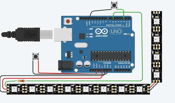

Color changing neopixel with button ending with2 white LEDs
Hi everyone,
I haven't coded in years but decided to take on a project for my own interest this weekend.
I have searched the forum but not found exactly my problem. I did use various codes from around the net and merge them to do what I wanted so there might be some unnecessary stuff that I haven't figured out I can remove yet.
The goal is to have an arduino make a 12 pixel neopixel change color every 10 minutes ending in all white pixels. I have been doing this on TinkerCAD. I have the following code (note that I reduced the times while working since I don't actually want to wait 10 minutes between each color change while writing the program) which does what I want, except for some reason the last direction to make the pixels white results in only the first 2 pixels turning white. My workaround has been to add the strip.clear() command to get rid of any other colors. But ideally I'd have 12 white pixels, not just 2.
I know that this is maybe just a TinkerCAD problem and it won't happen when I eventually get my hardware.
Would anyone mind giving a quick check and telling me if I've missed something?
Thanks

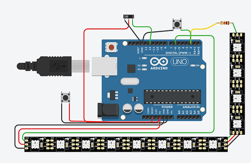

Hi again,
In addition to my post about the 2 white light issue, I'm hoping to add a switch. The coding below is not finished, but I'm hoping someone can tell me if I'm going about this a logical way or if there is a better way.
What I want:
2 position switch:
  • Position 1: no action until a button is pushed, then a preprogrammed light show happens
  • position 2: no action until the same button is pushed and a different preprogrammed light show happens.
so basically, 1 switch and 1 button to control 2 programs.
Does that make sense? Am I going about this a logical way?
If someone can tell me how to add a picture I can post the mock up in TinkerCAD
Thanks for the help

Here is a picture of the mock up
Your slide switch is currently creating a short circuit. <- see what I did there?
… or is it?
What is a resistor doing between DOUT of the strip and pin 2?
Both pushbuttons shoukd be wired between the respective input pin and ground. Both input pins shoukd be INPUT_PULLUP.
Both pushbuttons will read LOW when pressed.
Can't see clearly, but you are using the RESET pin somehow; this is not typically necessary.
A hand drawn schematic would be preferred. Just draw it, snap a celly and post it.

Thank you for your feedback :slight_smile:
I will check the slide switch, I'm not really far enough into that yet to have realized it was wrong. Can you advise where to put it?
The resistor was there in the pre-made schematic so I left it. I can move it to before pixel 1.
The pushbuttons work fine in the simlator (but I understand what you are saying so may need to be switched to LOW in the real thing).
The reset switch is correct. I want to make access to the reset function of the board without having to touch the actual Uno board. Therefore I can wire the reset switch to be attached to whatever I decide to put the circuit in. The way the light show is written currently, I cannot stop it by pushing the button. But if I reset the board it does stop the show and reset everything.
Do you have any advice for the coding to make the slide switch do the 2 different actions? (same button but different light shows).
I suspect I need something like
If switch set right, then pushbutton triggers light show A
If switch set left, then pushbotton triggers light show B
I'm just not sure how to get going on that.
Thank you for your assistance
