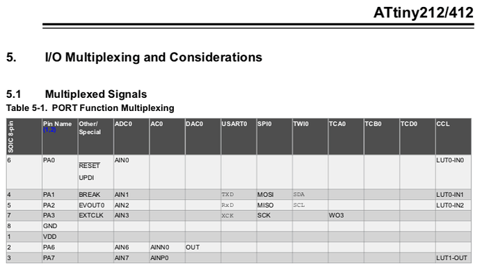

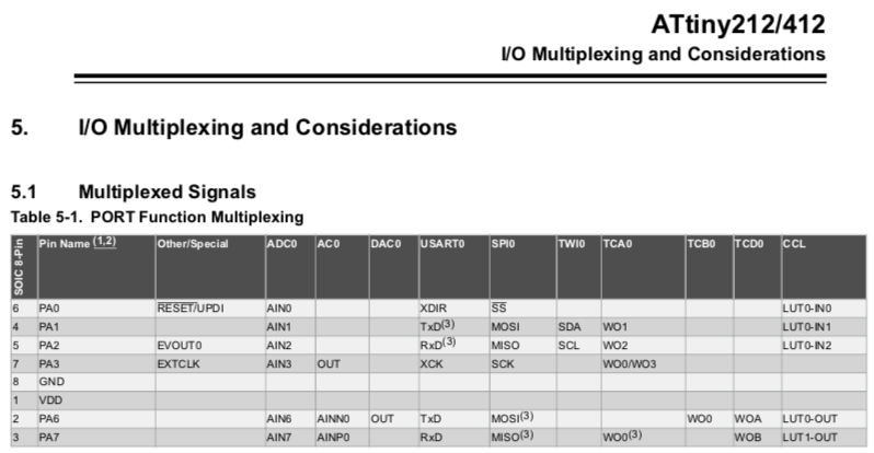

there's only 1 hardware output compare pin
Oh, wait! The datasheet has changed! "I/O Multiplexing and Considerations updated"
DS40001911A(2017):
DS40001911B(2019):
westfw:
DS40001911A(2017):
DS40001911B(2019):
ARGH! Figures that I saw that post like an hour after I did 1.0.4 release!
Support for those will be in 1.0.5 of megaTinyCore. So was the original one like... just wrong?!

1.0.5 is released with the newly disclosed features (more PWM pins, UART remap option) for the 412/402/212/202 - Manual version is already available for download, board manager version will be out in the next day or so (waiting on the json file getting updated)
