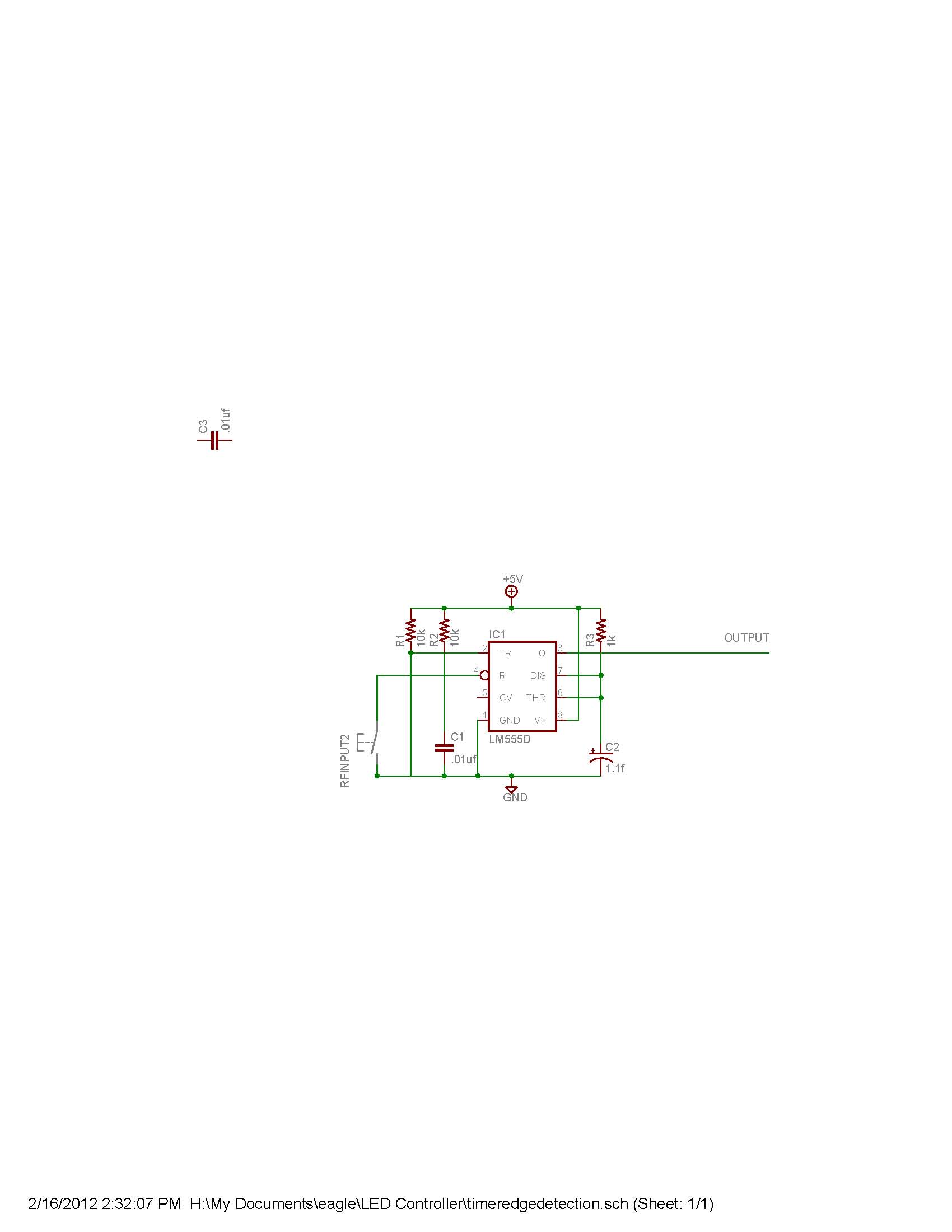

Ok Now that i managed to get a RF controller to work in my project ( this one contains relays ) I managed to get everything working on my mega 2560 ( with a few bugs ). I now tried to reduce the size using a nano v3.1, seems now the relays switch the code on press and release so what now happens is for every press it steps two. I am baffled.
I know this may be a dumb question but can i install a flip flop circuit between the rf button signal and the digital input pin of the nano to eliminate the debounce. I think with the relays they are changing state too slow and misrepresenting the button presses
Something like this
All mechanical switches bounce, giving what appears to be multiple button presses. Here is a library that will help with any mech. switch. http://www.arduino.cc/playground/Code/Bounce
