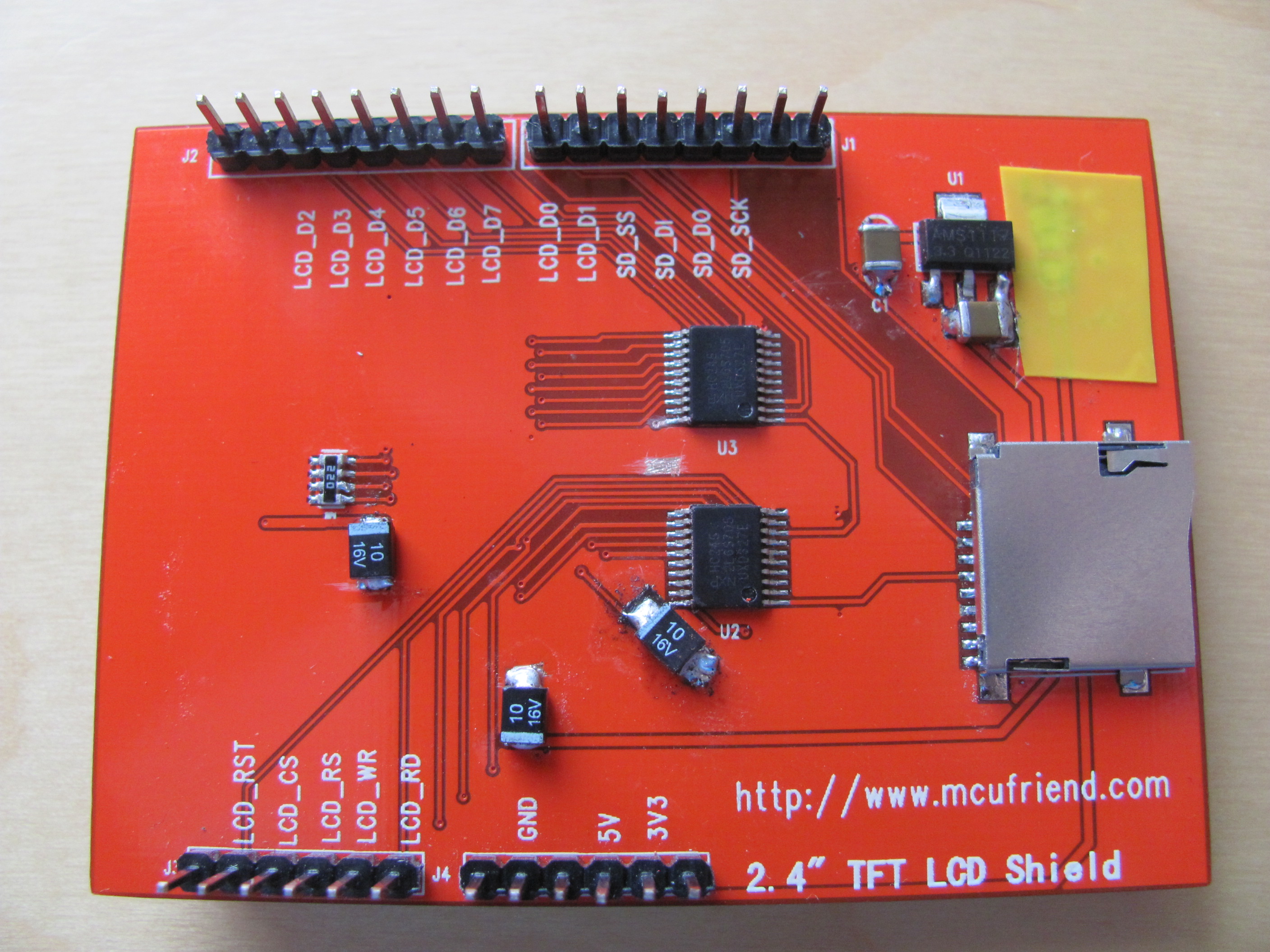

Hello, I have solved the touch issue. It was wrong Touch communication pins settings because LCD library is using PORTC instead the original pins.
Also we fixed the LCD module problem of flickering. The Display has filckering issues and it is because LM1117-3.3V regulator used onboard to add 3.3V for the display from 5V without onboard caps altought there is planned pads for them. The producer removed caps from the regulator so we soldered 10uF ceramics to there:
How ever 5V cap is not suited to UNO because USB port is so high that the cap touch the USB connector and therefore display pins are not able to connect to the ports. 5V cap needs mod. Also the board needs Arduin 3.3V mod. 10 uF regulator to 3.3V line is needed to added because it has noise and multimeter reads 3.9V from 3V3 Arduino pin after lcd module installed:
Now the Arduino 3V3 is stable indeed mutlimeter reading 3.29V stable.
Also the 5V cap joints are needed to shield with electrical tape anyway to prevent display get shorted to the ground via touching the usb connector.
Final mods:
Since 3.3V for the display makes U-type long line with 3 vias I added to end of the lines couble caps to make sure that display gets clean 3.3v. Not much improved tho.
