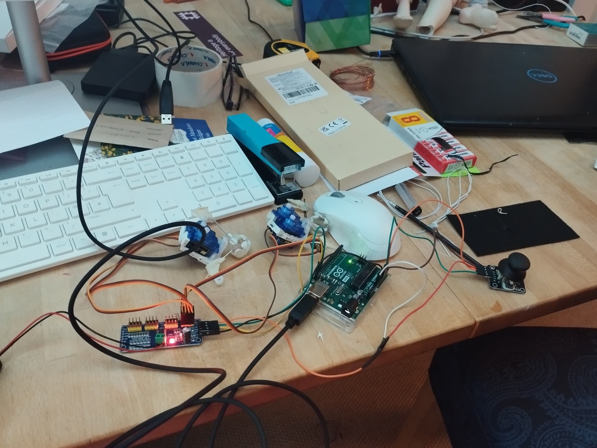

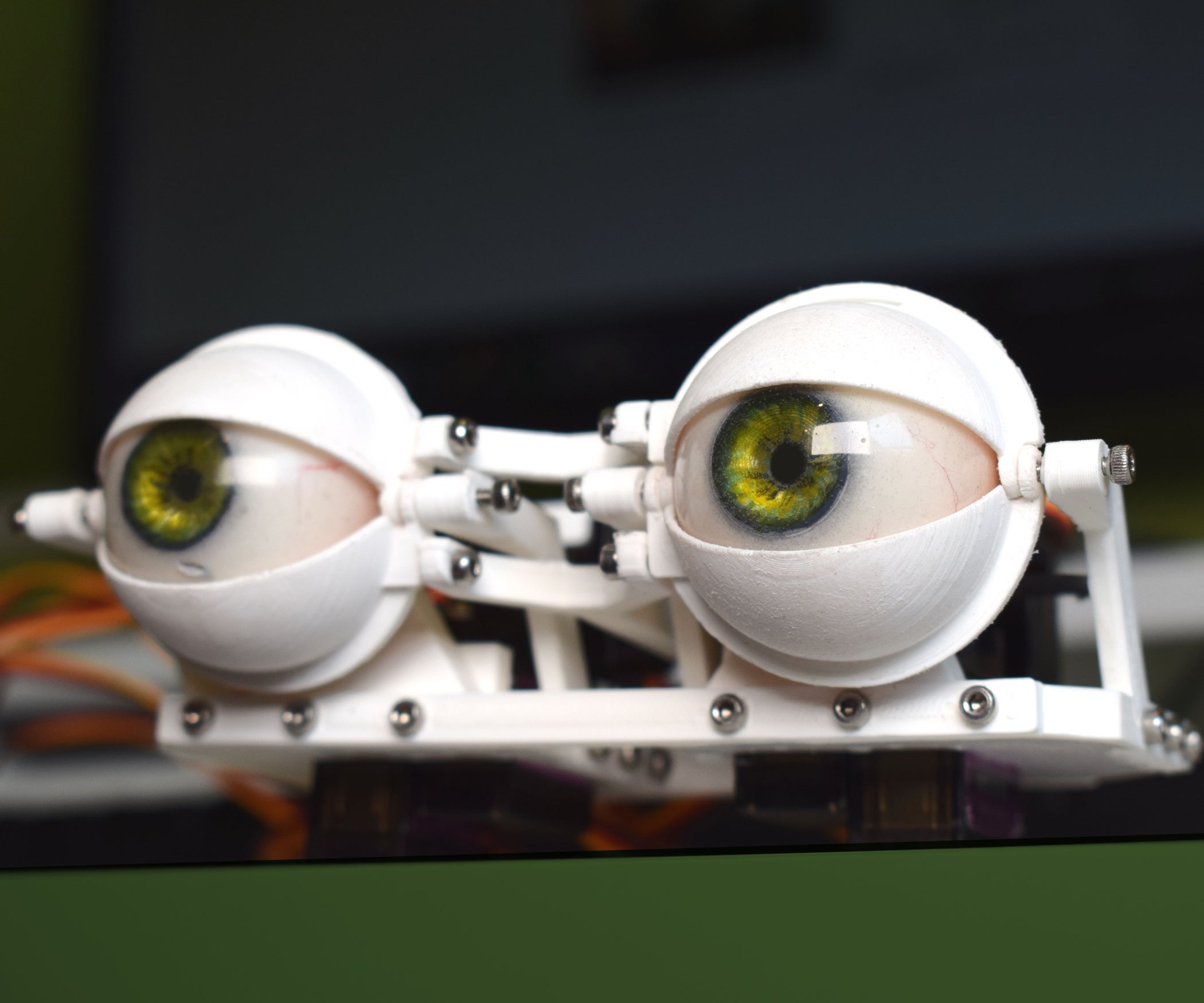

I'm trying to get 4 servos to move on a joy stick, I work with puppets but want to use animatronics for the eyes, I started off using this tutorial:
I removed the eyelids from the design so when the code initially did not work i suspected this was the problem,

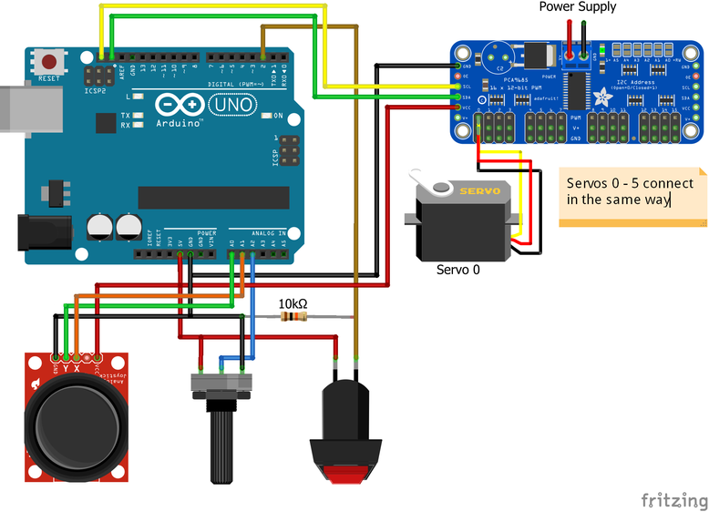

I then found this tutorial: https://www.brainy-bits.com/post/control-a-lot-of-servo-motors-using-a-joystick-arduino-and-pca9685-pwm-module#google_vignette
but the code will also not work for me
I have tried to search around for the issue, but i'm much to code illiterate to work out what is happening. I have only made one change to the original code, which is to change HCPCA9685 to PCA9685 to reflect the difference in the original codes library and the name mine has (for some reason idk)
this is the library btw

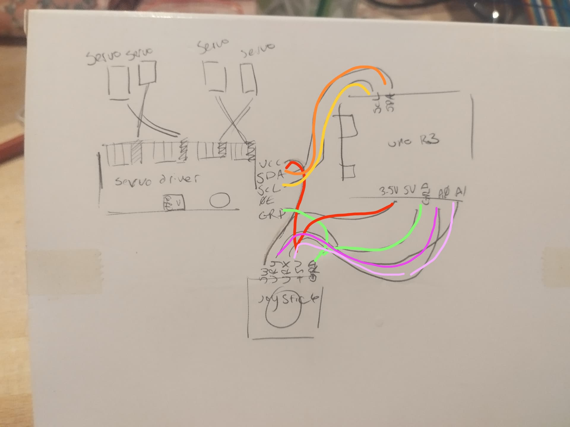

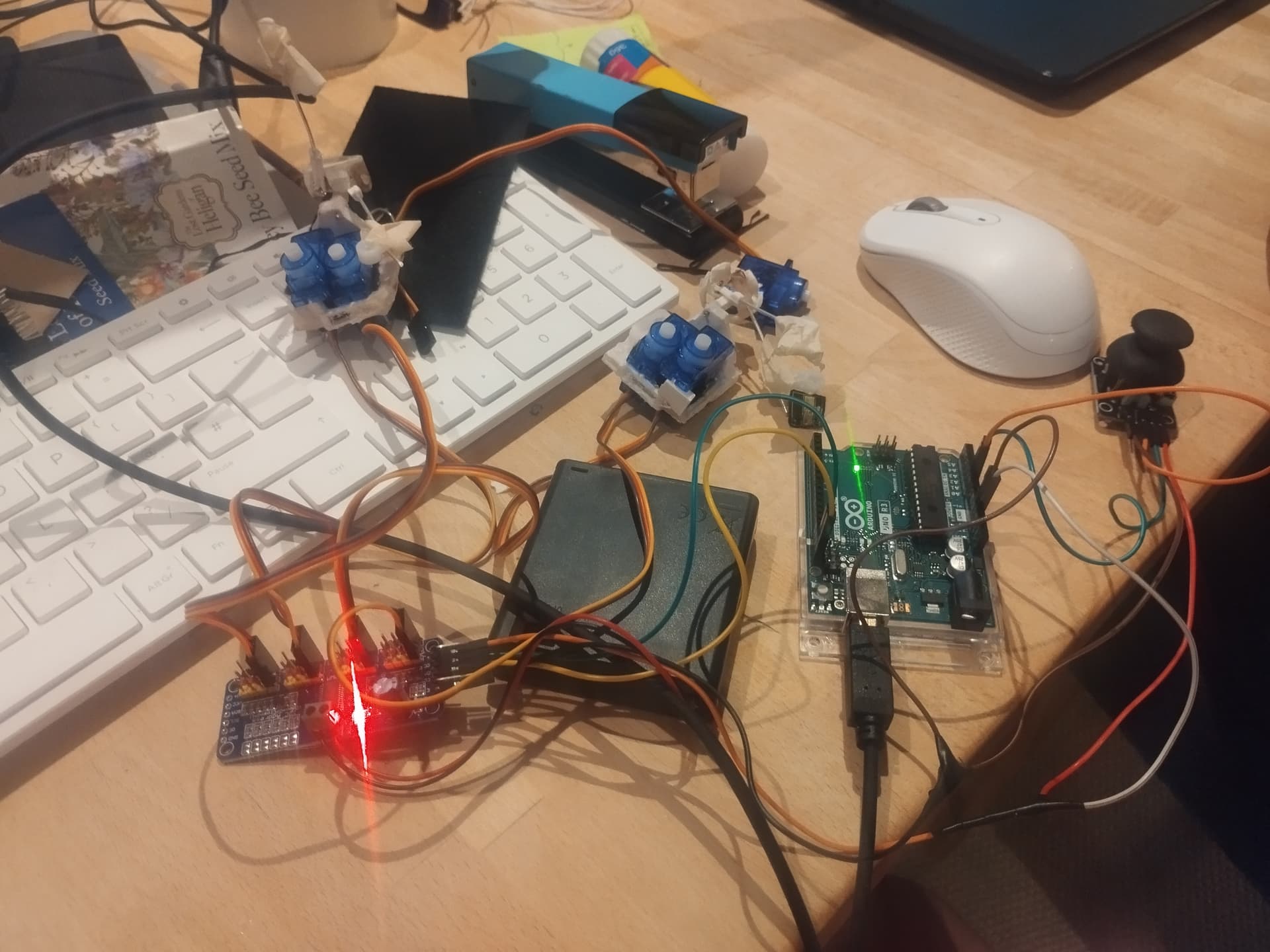

this is my wiring, I'm like 60% its correct but who knows, I can't get the code to work :melting_face:
Please help me, sorry if i'm being dense
I'm using an UNO R3, Adafruit PCA9685 16-Channel Servo Driver, 180 Degree servos

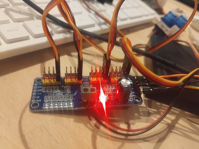

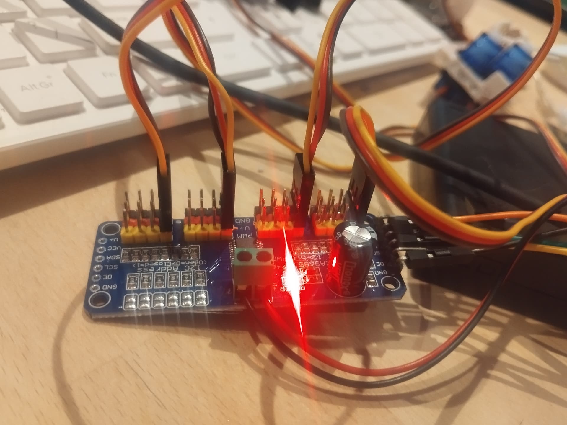

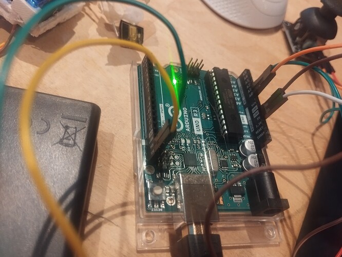

If I'm reading that tangle of wires correctly, you're powering the servos from the 5V pin of the Arduino.
Never.
Do.
That.
Not even one Servo. They can draw several hundred milliamps, and that will very likely damage your Arduino.
The pinned post called 'How to get the most from the forum' will tell you how to post code so that it is usable by the helpers; currently, it is not.

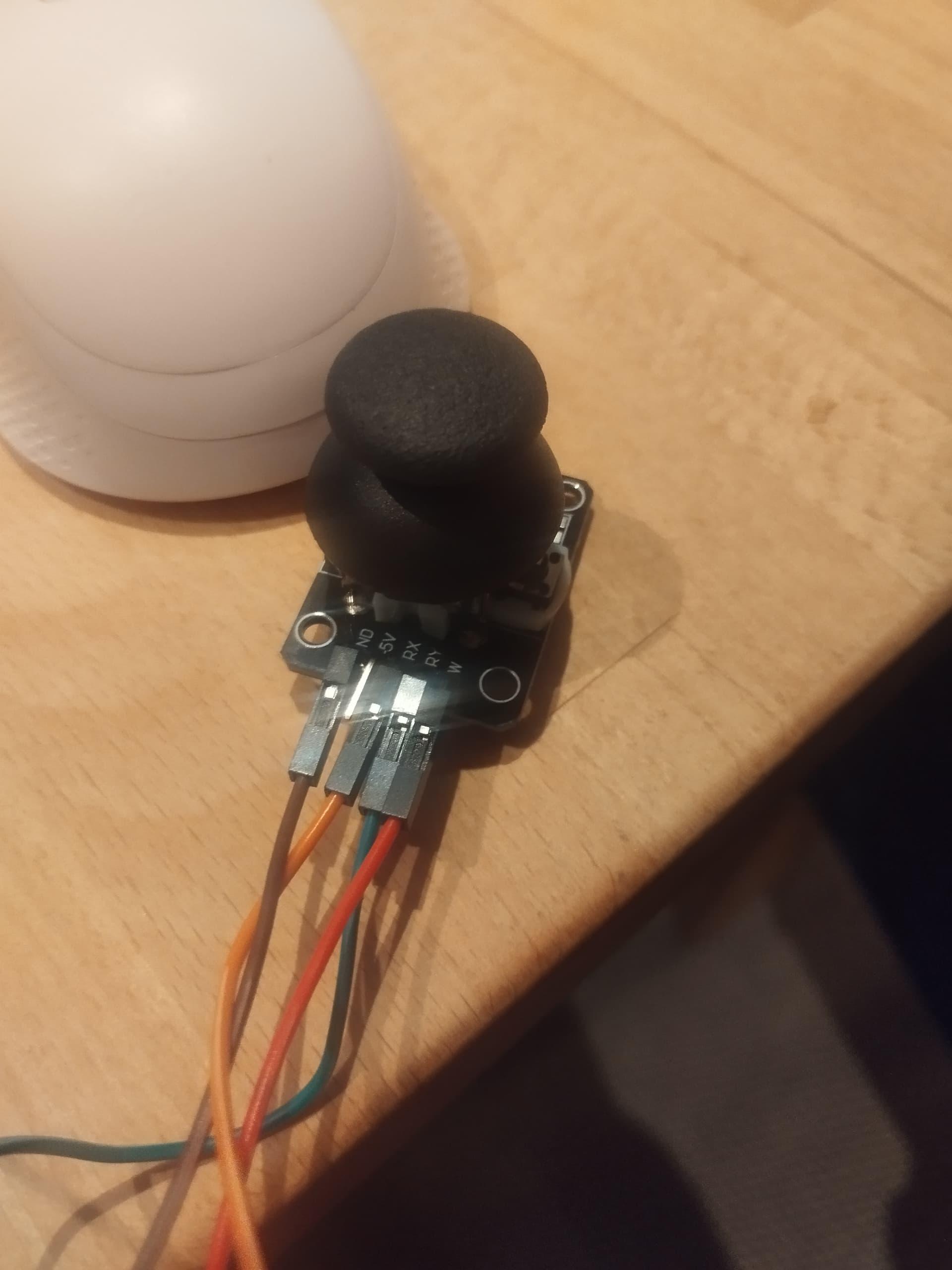

The second point is to make a hand-drawn wiring diagram, then take a photo of it. HOWEVER, it may be smart first to simplify things. Only one joystick and one servo are needed; once one works, they all will (servos, joysticks)
It will be interesting to see the power arrangements.
I'll draw up a diagram and unfortunately you are correct i'll move the pin :sob:

Don't forget you will need a seperate power supply for the servos. A wall wart is the easiest, just make sure it is rated for 4 x servo max.
It is one joy stick, 4 servos is the minimum amount I need for the movement, I would usually used 4 cables!

It's rough sorry
There is also a battery pack for power and I have extra if need be

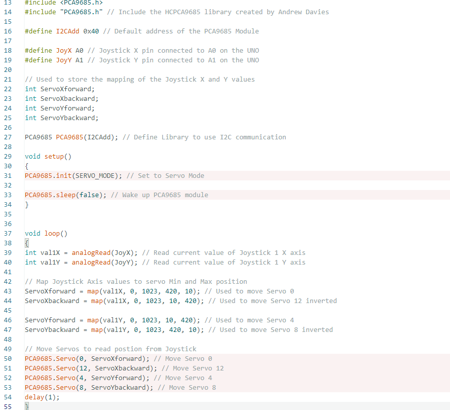

include <PCA9685.h>

This is the code I want to be able to use but doesn't seem to work.

Seems that you are using the wrong library (not the same library that was used in the tutorial code from brainy-bits.com.
Make an account on https://forum.hobbycomponents.com, then log in there and download the "HCPCA9685.zip" file linked at the bottom of the first post in this forum thread:
Then, use the following instructions for installing the library:
https://docs.arduino.cc/software/ide-v1/tutorials/installing-libraries/#importing-a-zip-library
