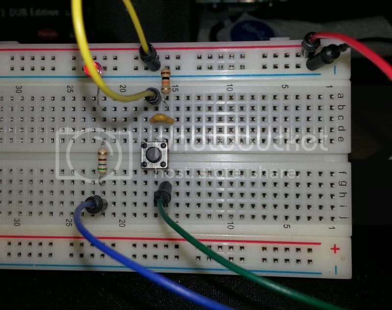

Thanks for your help. I know I have done something wrong, but I cant see for the life of me where. I have included the schematic:
http://i8.photobucket.com/albums/a41/acharris05/schematic_zps85fdb36d.jpg
My circuit and sketch is below. I kept the capacitor in just to show my full circuit design. it is a 10k resistor by the switch, a 560 ohm resistor in line with the LED. The blue wire is from pin 7, and the green is from pin 12. and the yellow link wire is going from next hole to the resistor and linking to the GND. And built like this, if I touch the blue wire, whether it is connected to the breadboard or not, I can cause the LED to light by holding the blue wire. Thanks again for the help.
http://i8.photobucket.com/albums/a41/acharris05/mycircuitlayout_zps8477743d.jpg

It is hard to see but it looks like the 10K and switch are not wired right. As you only have two legs you have to make sure they are in the right holes in the breadboard.
Thanks for that, that is what I am wondering. Below is a more square on shot, and the pins for the switch are in F17 and E17 holes.
http://i8.photobucket.com/albums/a41/acharris05/betterlayout_zpsf00e8567.jpg

Grumpy_Mike is right. I went to your Photobucket site and selected the picture, after which i was able to see it full size. The blue wire is in grid d30, but the switch is in grid e29, so there is an open line. It is invisible in the picture where the other pin of the switch is, but it's likely it is in f29. It's also invisible to see where the resistor goes, but that seems to be in f30. One side of the capacitor and the yellow wire are in g29 and i29, but if the switch is in f29, it is directly connected to GND The other leg of the capacitor goes to g31, which seems to be connected to nothing (should go to D7 according to the schematics).
So, try this: Put the yellow wire in i31. Put the resistor in j29. Put the blue wire in h29. Put a new red wire in the 5 volt rail and in c29.
This way you will have it connected according to the schematics. And also according the sketch. Try if this works.
Later on, after you got this working, we'll be glad to help you set this same thing up in another way so you can get rid of some components and have the same functionality. But that's for the next exercise.
Edit: This was about the first picture today, the second one is built up completely new and is not the same as the one before. It is important that you keep working the same way. Do not change wirecolors between 2 versions of the same circuit unless you're very sure what you're doing (you also shifted the blue and green wires in the 2nd picture)
Yep it is the wiring. Not only is there nothing connected to one side of the switch, the input should be connected to one end of the resistor with the other end to 5V. Then the switch should be connected to the resistor with the other end to ground.
Don't go so much on the photo in that chapter in fact do not follow it at all, try and follow the schematic and recreate the same topology.
A big thank you for all your help, I followed the above advice and the circuit now works as it should. And by having the circuit now correct, and then looking at the schematic that was in the book I understand a lot more how the diagram works, and how the picture in the book shows the circuit setup wrong on the board, leaving the one side of the switch not connected, like was said above.
