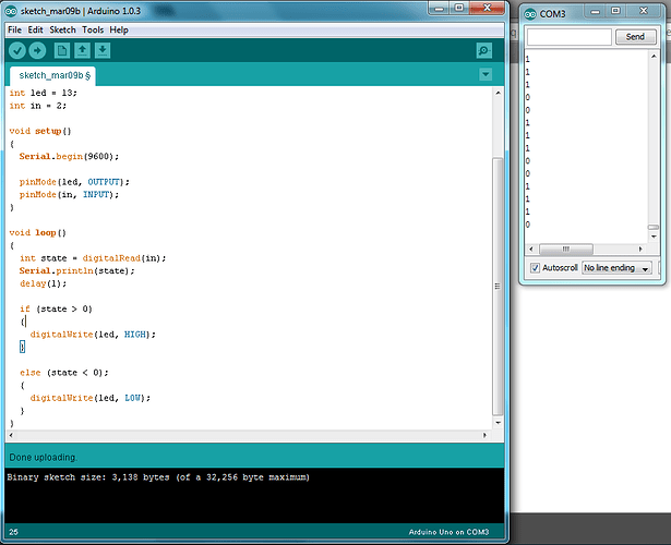

I'm trying to make a small led light show for my first project but I'm having problems with digitalRead. The layout is very basic right now as I'm trying to plan. So I have two separate circuits. The button circuit from 5v to GND, which is the input when pressed. The other circuit is a simple led (pin 13, resistor, GND).
The Serial Monitor is displaying 1's & 0's randomly when the button is off resulting in a low flicker of the led. Then all 1's when it is pressed, which is correct.
In all honestly, I don't know if this is a programming or hardware issue. I've been trying different arithmetic to make it all 0's/off but to no avail (= 0 LOW, = 1 HIGH). If you have any suggestions they would be much appreciated.
int led = 13;
int in = 2;
  pinMode(led, OUTPUT);
  pinMode(in, INPUT);
  int state = digitalRead(in);
  Serial.println(state);
  delay(1);
  if (state > 0)
    digitalWrite(led, HIGH);
  else (state < 0);
    digitalWrite(led, LOW);
The pin is "floating". You need a "pull down" (aka "pulldown") or "pull up" (aka "pullup") resistor. Tutorial explaining...
http://www.ladyada.net/learn/arduino/lesson5.html
It sounds like the input pin is floating.
Try this
  pinMode(in, INPUT_PULLUP);
It will keep the input HIGH when the button is not pressed. Arrange your circuit to connect the pin to GND when the button is pressed

Yeh, typo. It was supposed to be 5v > Button > Input Pin.
That's amazing! I'm getting solid numbers between states now after using the resistors.
It was the internal resistor on digital side GND that was throwing me off. As when I used it in the tutorials, but on my project I used the power side GND's.
