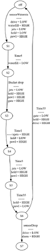

I am new to this so please bear with me. I am trying to run several different delays in my code to give time for machinery to move into place etc... I am concerned that my use of multiple delay variables will not work as the code keeps resetting the current time based on example code I found. Thoughts? Sorry about the length - I'm not even sure if it acceptable to post this much code... like I said, new to this.
This is for a machine that de-stacks buckets at one station and then adds water at the next. Homemade in my garage.

After only a second's glance, I've got to say that some of the overall logic looks iffy to me. I suspect you need distinct previous... variables for each of your delays at a minimum.
But as far as the delays themselves go, I'd get rid of currentDrop and currentWaterstn and just use millis() in their place.
Also, you'll likely need to either reset the previous... variables to zero after the delay expires and add a test for a non zero value like so if( previous... && millis() - previous... >= DELAY_TIMExxx) or add a flag that's set when the delay is running. Setting the previous... value to zero when the delay expires does it w/o an extra variable.

A process like your code attempts to model is best represented as a finite state machine. You best start with a diagram where each state is identified such as WAITING_FOR_BUCKET or FILLING etc. as are the rules or triggers for the transitions between those states such as "water level detection switch triggered" or "10 secon timeout reached".
I suspect you're also missing a state machine to handle sequencing all those delays but it's been a long day here and I likely need to sleep on it.

See here for an example of a state diagram which can more less be coded from directly: Make an output pin behave like a monostable multivibrator - #12 by 6v6gt or here: With millis() i have to wait after loop finish - #52 by 6v6gt
I like this approach as there are some sizeable delays which could cause errors (phasing?? - where actions are out of synch). I believe I am grabbing millis() early and storing it in currentWaterstn & currentDrop.

after "timing out" what prevents a sensor from immediately turning things back on?
also looks like multiple timers may conflict with one another, don't each of their else conditions override what happens?
how would the DELAY_TIME3 timer ever expire if the DELAY_TIME1 timer resets previousDrop when it expires and similarly for DELAY_TIME35
it seems like the sensors input trigger a sequence of "timed" operations
this might be what you're trying to do

New to this - so thanks for the link to Graphviz. It helps to visualize things. My challenge here is that I have two separate loops that are interconnected with one loop reigning supreme (water fill loop). Now that I look at it, it might make more sense to link the timing of bucket drop directly to the water fill station - so they always happen simultaneously. I can use the sensorDrop as alarm exit point instead.

my primary point is that i don't believe your timers are working the way you think because of
  • the else cases
  • they are all active at the same time
  • they use the same timestamp variable
Agreed. I am going to implement the changes as I understand. Back to my day-job for now :frowning: I'll report back on my progress. Many thanks to all.
