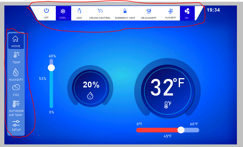

but I am beginner in the Arduino. i am doing one project using Atmega4809 and Nextion display. for Nextion display already i created the GUI (HMI File). in this GUI 32 pages is there and now I want to communicate this display with the atmega4809. but I am getting stuck because I am not getting idea i am writing right or wrong code . so please help me in this.
problem:- 1). in GUI I have 32 pages and on every page I use system mode and fan mode. fan mode will be off or on and in system mode- off, cool, heat, cruise control, emergency heat, dehumidify and humidify but in system mode one will be selected at one time and same for fan mode. and also if i will change these from any page then it will be change in every page.(i already shared the screenshot and I used dual state buttons)
2). I used left side button for opening the pages - home, temp, hum, co2, outdoor air temp, setup.
I want to write the Arduino code for this
functionality so can anyone write the code for this functionality then I will get the idea and I can complete my project for all GUI.

See Using Nextion displays with Arduino
If you use my methods and get stuck I will try to help.

SoftwareSerial nextionSerial(48, 1);  // RX, TX pins
The 4809 has 3 hardware serial ports you can use for communication with the Nexion. There is no reason to use Software Serial.
Most simple would be to use Serial1 on Rx and Tx if you were using a Nano Every, but it's not clear what pins you are using for what purposes on the custom circuit board and which of the three serial ports would be best to use.
