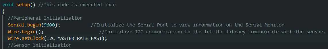

Hello @engineermonke
Thank you for reporting the issue and sharing the detailed context of the problem you're facing with the Nine Axis Motion Shield. I’m sorry to hear about the challenges you’ve encountered.
To address the problem, there is a potential fix you can try:
Just after the line:
Wire.begin();
Add the following line:
Wire.setClock(I2C_MASTER_RATE_FAST);
This adjustment should help resolve the issue and enable correct readings from the accelerometer and magnetometer.
Unfortunately, this library is marked as deprecated, so the current solution is to implement this workaround.
Please give the proposed solution a try and let me know if it resolves the issue. If you continue to encounter problems, I’ll be happy to assist you further.
Apologies for the inconvenience caused, and thank you for your patience. Wishing you a great day!
