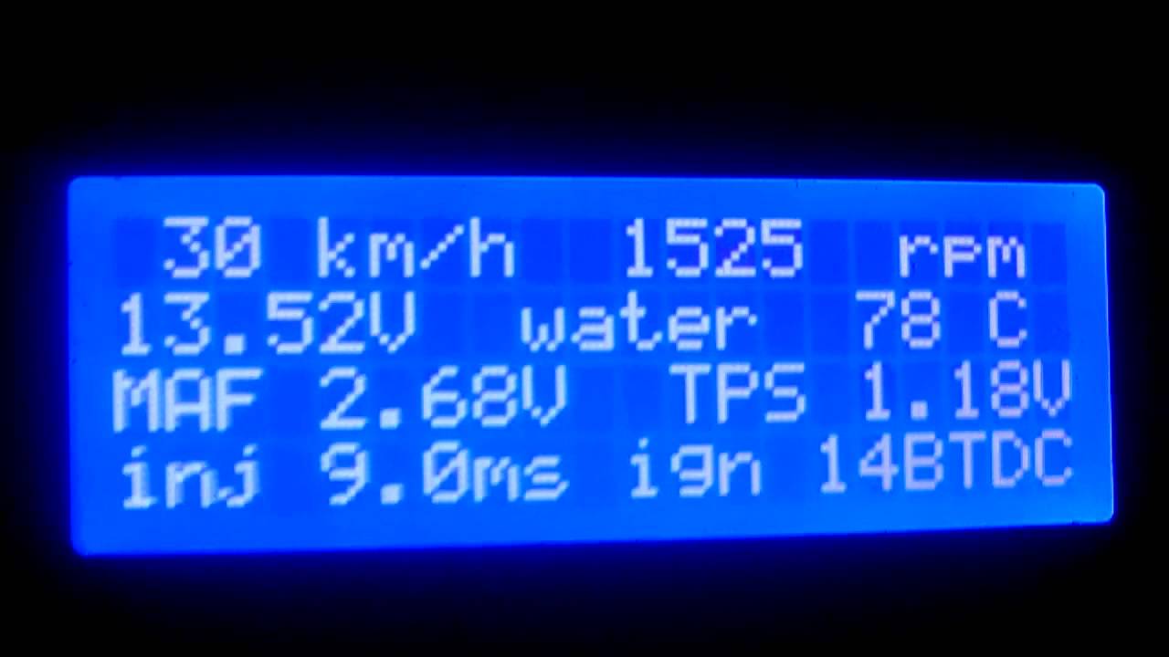

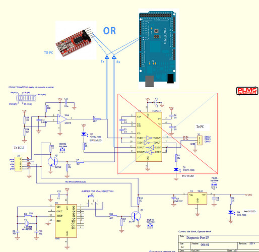

So, after working on this a little more, I believe the issue is the RS232-TTL adapter not communicating correctly with the consult adapter. The way i tested this is using two adapters, one male & one female, and hooked them up to eachtother- rx to tx and tx to rx. Gave them both 5V and tried to see if it would just pass the signal from the USB adapter through - it wouldn't.
SO.....my next idea is to use a USB host shield along with the USB cable (based on the profilic 2303 chip) I have and see if that will work. I did get some serial data sniffed using a software serial sniffer so I can try and emulate those commands via the shield. Only problem - I doubt anyone has any libraries for this and I'm not good enough at programming to write my own since I doubt it's as simple as just sending the commands and listening for reply. I'll do some more research on the usb shield and see if that helps or not...
so a bit of an update to this, I found a person in europe who did this a while back with a serial interfaced arduino (the freeduino max serial). They don't make the boards anymore, but NKC had had some PCBs for them, so I ordered a couple PCB and the components to build my own. Hopefully I can get it to work without needing a USB interface - I was reading up on it and i'm not sure it would work at all.
In the meantime I'm trying to learn to write my own library for this instead of using the existing. The existing one may work, but it's good to learn. Where i am at now is trying to figure out how to translate any data that the ECU sends back to something usable - particularly in the case of the data that is more than one byte.
Another update.
Using the other program I found I was able to get the consult adapter to work and display data correctly. Seems the previous library didn't do a good job of connecting with the ecu. the good news is that with the new program I was able to get it to interface using a RS232-TTL converter, so I will be able to use my Mega and maybe do some data logging as well as add some other features that I was wanting.
I'm using the interface and initialization logic from the other program I found an implementing it into a new program along with a couple other features (wideband o2, boost pressure, etc) as well as eventually doing some data logging.
Robtillart - thank you for the assistance in helping figure the library was wierd. Now that I found something that works I can go down a road that I know will lead to success.
Did you try swapping this so you connected RX to RX an TX to TX. This is needed sometimes because of the way equipment is classified as eithe DTE or CTE. This main a TX can be an input or an output. Check that you were connecting an input to an output and not two outputs together.
basicmods:
Hi!
I want to create device like you.
Can you plz explain for what purpose did you use RS232-TTL converter ? Why do not connect uart (tx-rx) to rs232 on consult adapter ? Seems Crim didn't use any converter at all.
RS232 uses much higher voltages than TTL level Arduino. A direct connection WILL damage the Arduino

here is a link to his youtube video showing what his code does. The link to his working code is included in his description.:

First things first - I'm building the cable myself. I will also want to try it with a PC via USB before working further with Arduino.
So as far as I understand - I can skip all the MAX232 part, since I don't need to convert ECU serial signal to RS232 and then back from it to USB, right? I just need to cross-over the Tx/Rx lines, correct?
