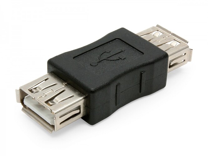

i am very new to Arduino's, Why would a USB host shield be absurd ?? how i think the host shield works, plugs into the board, then i can just program the Arduino to use the 0 serial port ? or am i completely off the mark with how the shield works ?
or would i be able to use something like this
and connect my cable and it with this
then just wire it directly to the board's rx tx 5v gnd ??

A USB Host shield would work but it is using a sledgehammer to crack a nut. You're adding a lot of complication on top of the basic serial protocol.
A RS232-to-TTL (or RS232-to-Arduino) converter is what you need. Chose one that's got a MAX232 chip (or one of the MAX232 family members). Wire that to the ground, RX and TX lines coming from the car connector. You may need to cut the cable that you have if the Consult connector is a strange one that's difficult to obtain.

Would connecting the USB to a USB-to-ttl work ? as the first USB has the MAX232 board in it already.
No, for the same reason that plugging two USB memory sticks into each other doesn't transfer any files.
