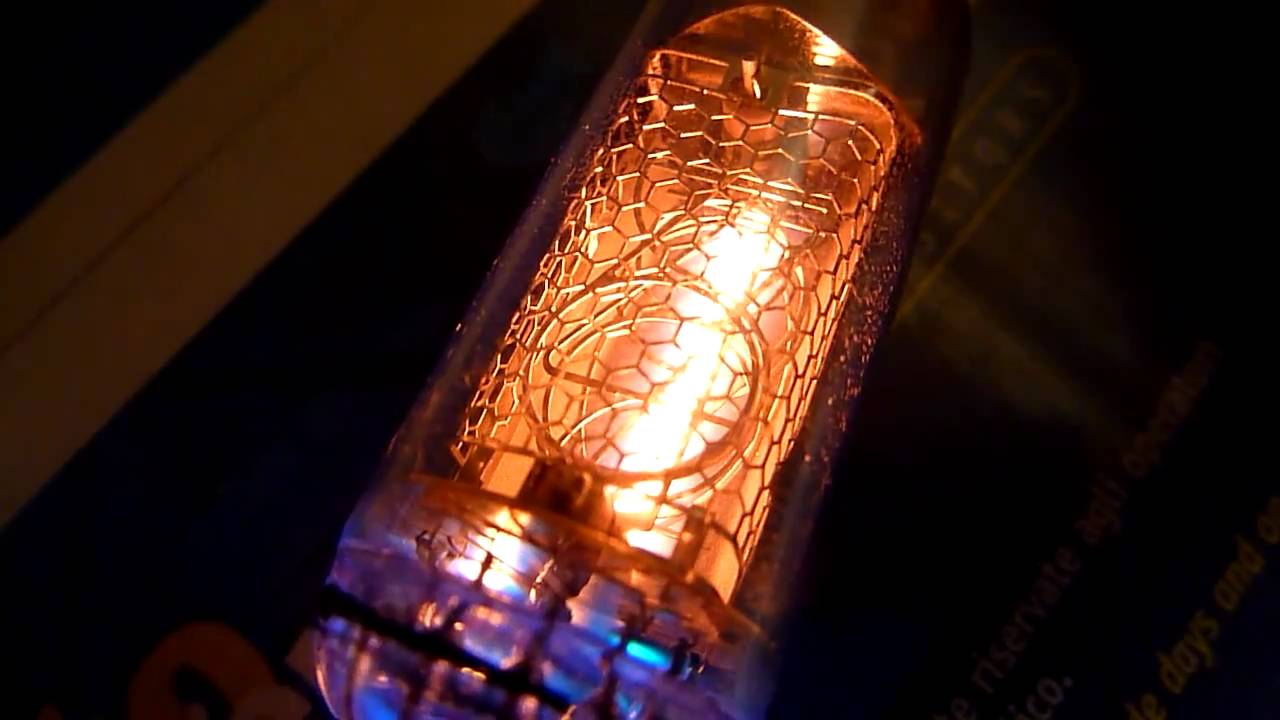

I've made a nixie clock.
It uses four IN-12s number nixies, one IN-35 bulb, four 74141 nixie drivers, two 595 shift registers, four 22k ohm resisters on the nixie anodes and a 200k ohm on the bulb. The nixies are driven by a 12v - 180v unit, the clock is a DS1307 (with battery backup).
The circuitry is currently all on a breadboard, I use a PC PSU for power (you may notice the arduino is powered by usb, this is the board I set fire to when I had a short and now only powers from usb. I knocked up a molex-USB cable). The nixies are suspended from a Meccano gantry, and the arduino is attached to the side of it.
Front view (using a flash):
Top view:
Every now and again it displays a load of random numbers. The amount and duration of the numbers is random, the interval between episodes is random (but a maximum of about once every 2 1/2 minutes - though it's currently shorter for the purpose of shooting the video). This is to give it a bit of a faux flakey technology feel, I may add a small buzzer to increase the effect.
Tomorrow I'll be putting it in a box tomorrow, including dumping the big PSU since the 180v PSU has a 5v output.
sorry about the quality of the video...

What sort of code do you use for cycling between numbers?
Fede
I like that fade. My original plan was to have it behave as if the power supply was erratic
nixieNumbers and nixieNumbersB are the nixie control functions.
  if (gap == 0) {
    int reps = random(50)+10;
    for (int i = 0; i < reps; i++) {
      nixieNumbers(random(99));
      delay(random(100)+20);
      nixieNumbersB(random(99));
    gap = random(255);
    nixieNumbers(hour);
    nixieNumbersB(minute);
    gap = gap -1;
    delay(100);

I use a 595 shift register to run two tubes, so I've got four 74141 chips and two 595 chips to drive four nixies.
User wyager told me what resistance to use. DON'T run one without a resistor, I broke a 74141 doing that.

The code is actually really simple and it's just a test code. I plan to do a more accurate effect, starting blinking slowly then fast till fixed lighted up, like neon when are broken
By the way, this is the code of my video:
int aPin = 4;
int bPin = 5;
int cPin = 6;
int dPin = 7;
void setup()   {
  pinMode(aPin, OUTPUT);
  pinMode(bPin, OUTPUT);
  pinMode(cPin, OUTPUT);
  pinMode(dPin, OUTPUT);
  randomSeed(analogRead(0));
void loop(){
  zero();
  delay(random(50,1000));
  blank();
void blank(){
  digitalWrite(aPin, HIGH);
  digitalWrite(bPin, HIGH);
  digitalWrite(cPin, HIGH);
  digitalWrite(dPin, HIGH);
  delay (10);
void zero(){
  blank();
  digitalWrite(aPin, LOW);
  digitalWrite(bPin, LOW);
  digitalWrite(cPin, LOW);
  digitalWrite(dPin, LOW);
  //delay (50);
