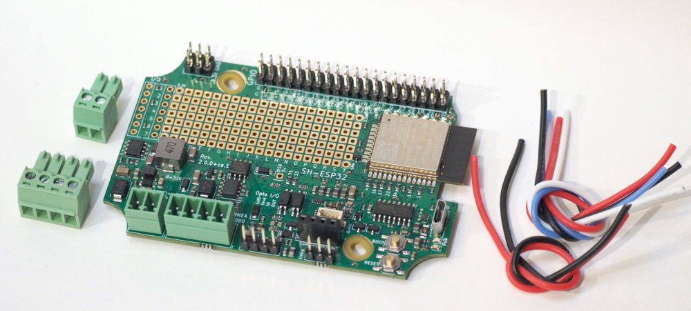

It is feasible. I have a working prototype of plan A, and am currently debugging. I'm using the Honeywell and an ESP-32 development board from Hat Labs:
I'm happy to share thoughts and code, although my documentation is not yet complete.

Hi Randel, I received my hardware from Hat Labs and am starting to work through this. First question involves the I2C connections. Did you use GPIO 21 and 22 for both the OLED display and the ADS1115, or did you use GPIO 21 and 22 only for the ADS1115 and use the separate I2C header provided on the SH-ESP32 board (from GPIO 16 and 17)? Thanks and I hope you're getting a lot of sailing in!! Chris
