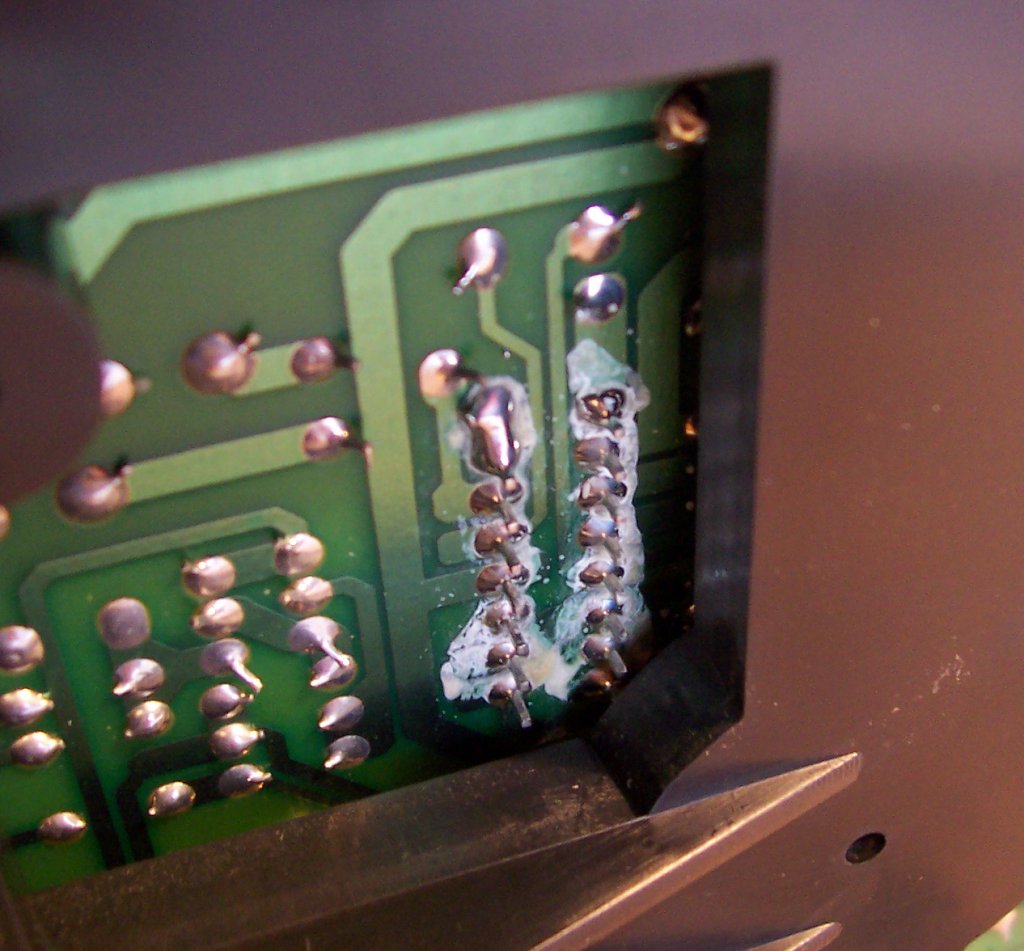

Here's a picture of the bottom side of the board where all of it's pins are soldered - it looks suspicious - like corrosion or something? Would that be the problem then?
Thank you for all your help cr0sh.
ooh, that definitely looks bad. try resoldering those connections and brushing the corrosion away
What's the best way to clean the corrosion without damaging the circuit board?

I would start by cleaning that residue off with some 91-95% rubbing alcohol and q-tips; make sure you remove any stray cotton fibers that get stuck to the pins. If the rubbing alcohol doesn't work, you can try some contact cleaner or similar (buy it at a place like Fry's Electronics - or some other large electronics store that stocks such chemicals). If that doesn't work - last resort might be some goof-off cleaner (well, actually last result would be some diluted pool acid, but that shouldn't really be done).
Once you have it clean, check the solder joints on the TDA7378 carefully, using a hand-held microscope if you have one (if you don't - get one - they are very useful for this kind of work, especially if you build your own boards). A powerful magnifying glass can also work. Jeweler's loupes are also handy to use.
