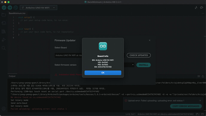

Even if you try to update the firmware, the device cannot be found.
The board has not been powered on for more than 12 hours.
Even if connected to a different USB port, the status is the same.
When the board is connected, the board information is read normally.

It may help, if you install firmware 0.2.1 first.
Disconnect and reconnect USB after every firmware update.
After installing 0.2.1, update to 0.3.0 should succeed.
See also: https://forum.arduino.cc/t/arduino-uno-r4-wifi-firmware-updater/1167083/4.

It's still the same...
All ports are normal, but the board is not working.
When uploading, the board LED status changes to bootloader mode (when the reset button is pressed twice).
Even if I try to burn the bootloader, it fails.

When I tried the instructions you provided on the same port where the error occurred, the connection failed due to the same symptoms.
I tried connecting to a different port and the firmware was updated normally.
