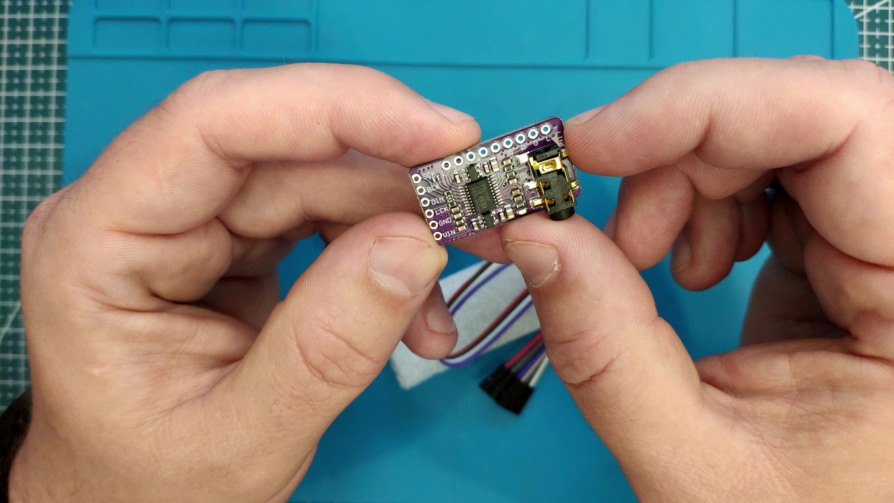

I'm trying to make an internet radio from this link:
I have a problem that there is no sound on the output in the PCM5102A, I have already tried everything, I changed the load, pins to see if it will work,and I looked at 3 different dac and esp32, but it not help. I have ideas already out , maybe one of you could help me? what else can be checked, where to do next.
Please post schematics. The video is useless in the English speaking section of forum.3
That is a nice picture of your hands but not much of your project. Hint: Most of the people on this forum speak English, I am one of them and the video was not understandable.

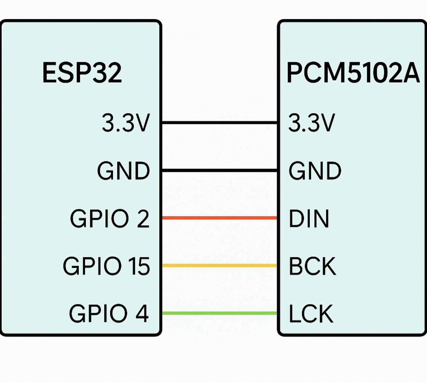

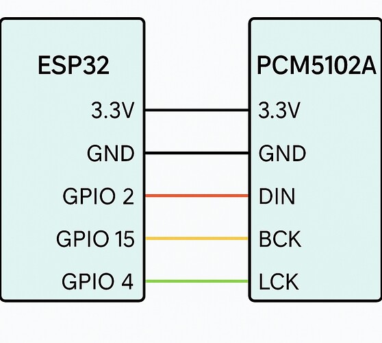

Esp32. Dac PCM5102A
P2 is to Din
P15 is to BCK
P4 is to LCK
3.3v go to vvc
Gnd go to gnd
Power is from Computer or from power supply 5v2A , Samsung charger

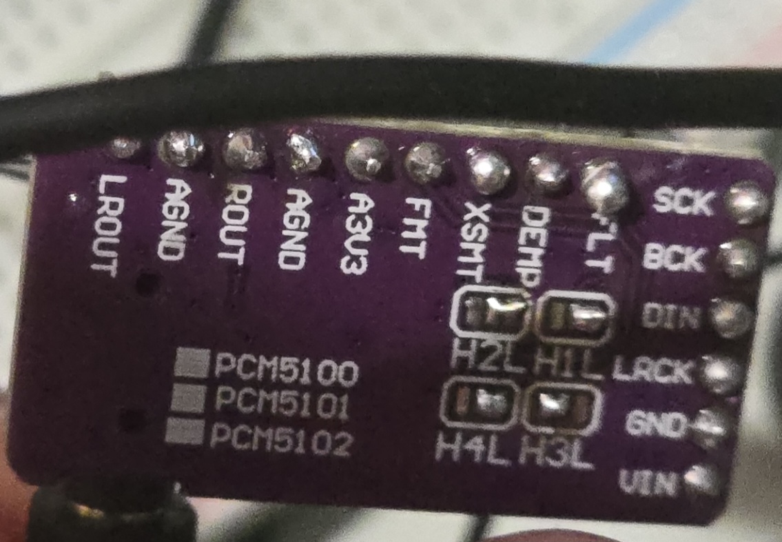

Jumper cofiguration on PCM5102A
H1L low
H2L low
H3L high

How about the schematic? Your description does notwork for me, I do not have the hardware to reference.
Please check the PCM5102A separately. I mean only the PCM5102 with an Arduino or ESP with a minimal code.
I also checked with the code "sound generator" in rhyme helped me gpt , there still silence , nothing can be heard .as far as the scheme is concerned, I will send a diagram exactly which is connected and a picture " jampers"
