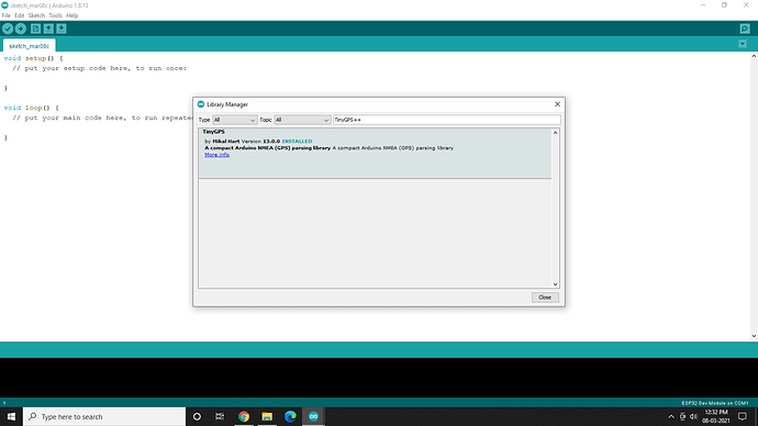

The libraries have been searched and installed directly from the "Manage Libraries" section.
Please tell me the exact name of the library you installed, as shown in Library Manager. There are thousands of libraries in the Library Manager and some of them have very similar names and use the same header file names. If I am investigating with a different library from the one you have installed, it will only be a waste of my time and not help you either.
pert:
Here is the reference for you!
OK! That's exactly the information I needed. I'll share the screenshot below so it's easy for any other interested parties to see.
What you have installed is the TinyGPS library. This library does not contain a header file named "TinyGPS++.h", so the error you encountered is normal and expected:
You can see that its header file is named "TinyGPS.h"

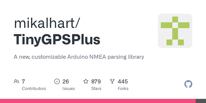

I see a library named TinyGPS++ here:
GitHub - mikalhart/TinyGPSPlus: A new, customizable Arduino NMEA parsing library
(though no guarantee that's the specific library your code was written for)
If you would like instructions for installing that library, I'm happy to provide them.
