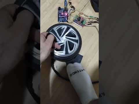

Hello all, i have problem that i cant fix or i dont know how thats why im here. So i have hoverboard motor motor controller and arduino, i want to control forward and backwards motor with low speed with key fob, i made everything and everything works good except for torque, i can stop motor with my hand and sometimes it wont start, all this i show in video i uploded.. take a look guys and let me know where is problem..

More torque requires more voltage to the motor. Low speed means limiting the average current by pulsing the current. Schematic or block diagram, please!

Have you tried any number higher than 20 as the parameter passed to analogWrite()?
Currently the motor is only receiving power for less than 8% of the time.

yes i did try, but speed is higher and i dont need that much of a speed, thats why is tricky for me.. i need low speed but to have torque
DC motors operate on current, noto voltage. Voltage is simply a means of controlling current. Motor torque is proportional to motor current. Getting high torque REQUIRES high current, regardless of speed. Having slow motion WITH high torque implies the presence of a high load. The only reasonable to achieve the kind of control you need is with a properly tuned PID controller, which controls either position or speed, and with provide whatever current the motor requires to achieve the desired position or speed. Simply varying PWM value based on desired position or speed will NOT work.
