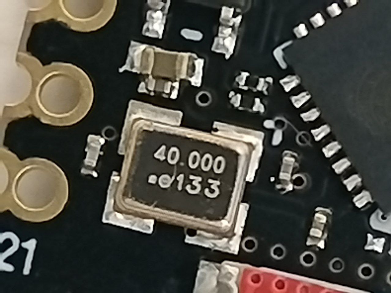

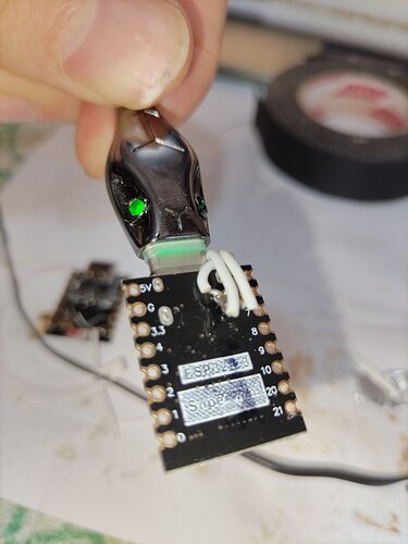

To address the issue that has been widely discussed here, several steps need to be taken.
1- Desolder the 40 MHz generator (see photo #1).
2- Solder it to the wires and move it as far away from the antenna as possible.
3- The generator has a metal housing that needs to be grounded to the negative terminal. If this is not done, the board will fail to connect via USB.
I soldered the housing to the negative terminal using a soldering iron (see photo). As a result, the board now has excellent Wi-Fi reception, functions well as an access point, and there are no USB connection issues.
Good luck with your experiments!

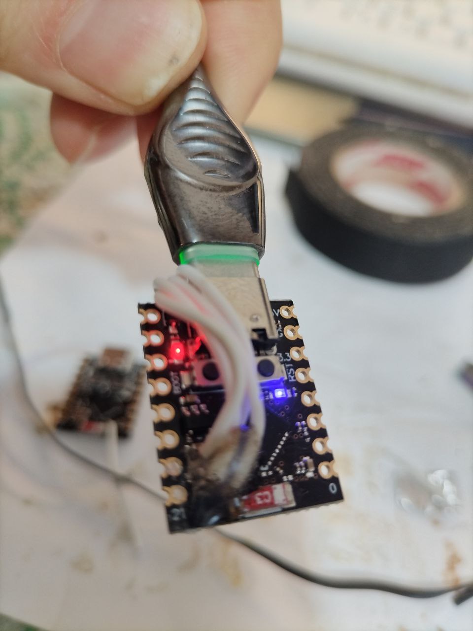

I tried foxsto2025's solution but found that my iron is too big to remove the oscillator. What did work for me was simply moving the antenna (the red component with 'C3' on it) further away! I desoldered it and added two thin (30AWG) wires and soldered the antenna to those. Looks a little funky but it works like a charm now. Good luck all.
