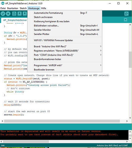

no Wifi connection
Board Uno Wifi Rev2 - None (Atmega4801), IDE 1.8.9., Firmware 1.2.1 installed, WifiNina 1.4.0 installed,
sketch AP-SimpleWebServer (arduino_secrets.h with SSid and 8char Pass)
Access Point Web Server
Creating access point named: WiFiTest
Creating access point failed
sketch ScanNetworks
Scanning available networks...
** Scan Networks **
number of available networks:0

Unfortunately, I don't have an idea of why the access point creation is failing. I can tell you that I ran the example sketch on my Uno WiFi Rev2 with WiFiNINA 1.4.0 and NINA firmware 1.2.1 and it works fine for me. Would you mind sharing a SECRET_PASS value you used with the AP_SimpleWebServer sketch so that I can exactly reproduce your configuration? You don't need to give me the original one you used if that's something you want to keep confidential. You can make up a throwaway password, but be sure to test it with the AP_SimpleWebServer sketch to verify that the AP creation still fails with the throwaway password.

I just tried it out with your same SSID and password and it still works fine for me. Hopefully someone with more knowledge than I will drop by and provide some helpful advice to solve the issue.

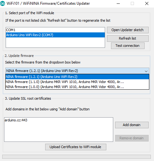

How can I test if the Wifi module is defective?
I don't know about a formal test but if you can update the firmware that does indicate the module is working to some extent (though it won't tell you anything about the network connectivity aspect).
I would try running the WiFiPing example. In the setup method it tests to see if the WiFi module exists (line 37).
The firmware update works.
WifiPing on line 37 shows not "Communication with WiFi module failed!"
The only thing I could suggest is to reflash the firmware, power cycle the board and retry the WiFiPing example again to see if that fixes it (another forum poster had a similar issue). Short of that you may have to contact your vendor to arrange a replacement...
Solved in my installation:
In 'AP_SimpleWebServer' Change: 'status = WiFi.beginAP(ssid, pass);' to 'status = WiFi.beginAP(ssid);'
Yes, the syntax is without "pass". See here.
I have already tested it: "Creating access point failed"
