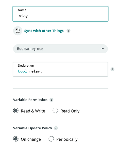

I am a beginner to Arduino IOT cloud.
I have created a simple thing as below,
created a dashboard as below,
Associated Device (Nodemcu and made it online by flashing the sketch using web ide),
Configured Network,
Smart Home integration set up as Google Home.
Now on my phone under google home app under devices trying to add the device above Nodemcu.
In Google Home App -> Devices -> Add device -> Works with Google Home -> Arduino -> Logged in arduino cloud with same account I used to create the thing and dashboard, Then I get below message,
I tried the same with ESP-WROOM-32 and getting in to same issue.
Attaching photo of both devices,
Any one been able to do this successfully?
Thanks.
I sorted the issue.
I had to edit the thing and Change type to cloudswitch,
