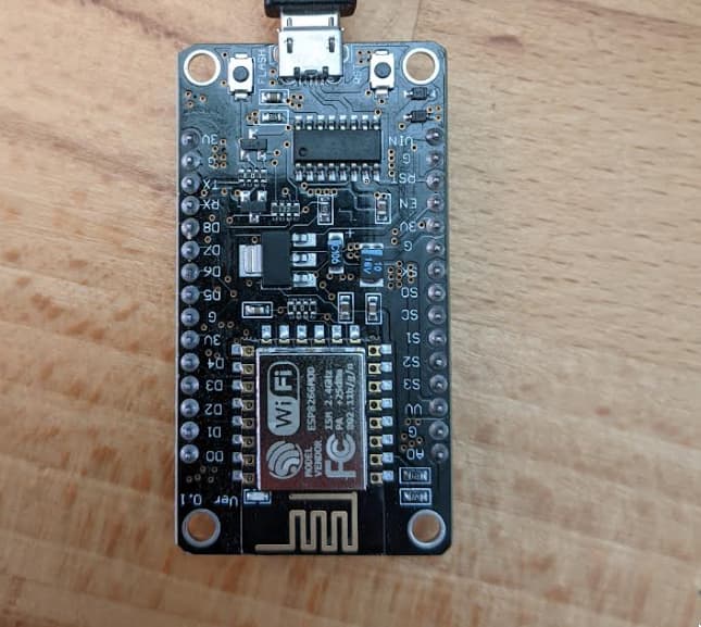

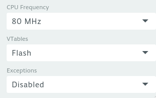

can you put a link or photo of the board you are using?
Hello. Here is the board I'm using. The fact is that I have tested with other NodeMCU manufacturer, and I have the same message.
I wonder if the pb is not in the scripts automatically generated by the Arduino Cloud IoT (initProperties();, ArduinoCloud.update();).

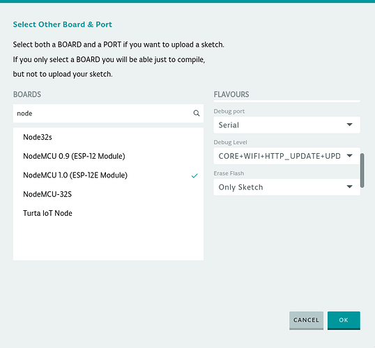

OK. Thanks... I will investigate. Do you know how I could receive more debug info (to know exactly where it stopps)?

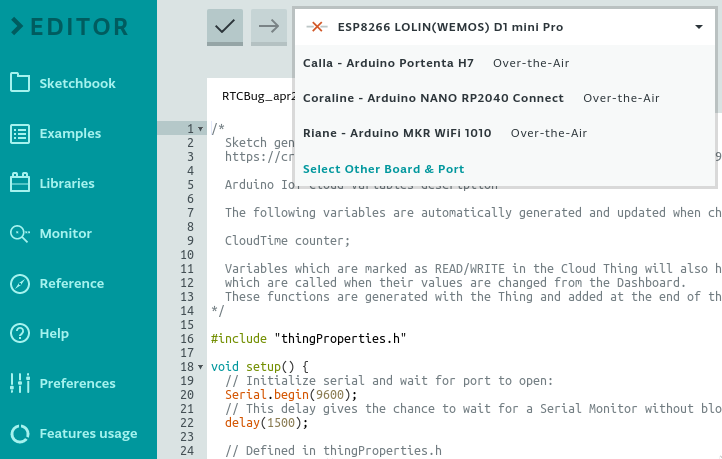

You can open your IoT sketch in the webeditor and change the ESP core debug level:
Click on select other board and port
Then re- select the nodeMCU board
Configure debug port to Serial and change debug level
CORE+WIFI+ ... should be fine
