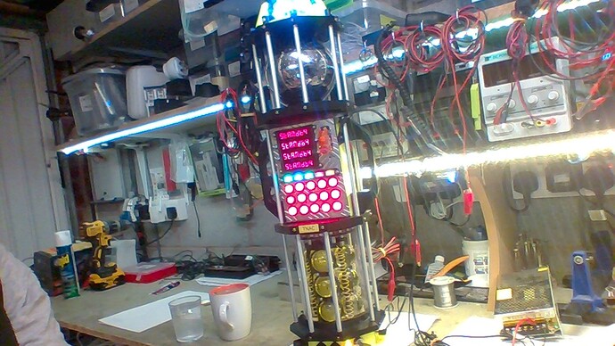

They work fine, but are introducing noise on my ground line, which is creating noise through the amplifier back in the main control box.
If I unplug just the displays, the noise immediately stops.
I have put ferrite coils on the supply lines, and caps directly onto each MAX7219 module, but the noise persists.
I have no options to add a separate 12v power supply (no room and the unit has only 1x 12v input), so I need to eliminate it.
Anyone else had issues with these modules? Any ideas for other isolation methods?
Help would be gratefully appreciated.

I would expect the problem to be caused by poor layout of the ground (0V) conductors, with current from the 7219 flowing in the same conductors that make up the ground for the audio circuits. Please post photos clearly showing how everything is connected up, the problem might be obvious.
As a general rule you need star grounding, which just means all the different grounds come together at a single point. In some manufactured equipment this is obvious because there is a nut and bolt in the chassis with lots of ground wires all terminated at that point.

Thanks all. Photos of this messy car crash will probably get me banned! Lol
I will draw up a schematic, and I started last night.... but I am using all the pins of the Mega2560p, so it's quite involved.
A for PSU... 12v comes in. Goes to a Stripboard PCB that houses 6x 7805 regulators. 100uf and 0.1uf on the incoming and outgoing of each.
These individually feed 6 sets of RGB Led strips.
12v goes directly to the Amp on a separate line directly from the 2.1mm input power jack, via a small relay that is switched using a TIP122. This allows me to turn off the amps when not needed.
12v Also goes to the front panel as mentioned earlier, that has it's own 5v reg to supply the MAX7219's and the illuminated buttons.
MP3 module is local to the Mega2560p and uses its onboard 5v supply. This seems OK.
