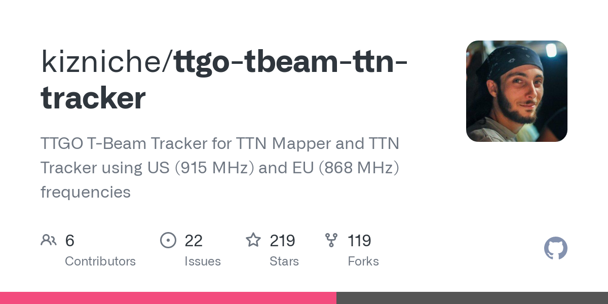

Dear Arduino-fellows,
I've followed this github project and wanted to build a lorawan tracker:
