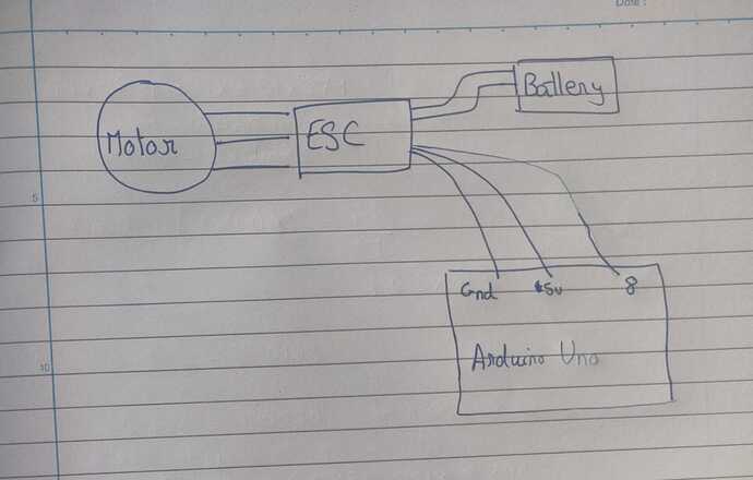

Not being able to use brushless motor
Hi i used the code below yesterday, and it worked but it is not working today
#include <Servo.h>
Servo ESC;
  ESC.attach(8);  //Specify here the pin number on which the signal pin of ESC is connected.
  ESC.write(2);   //ESC arm command. ESCs won't start unless input speed is less during initialization.
  delay(3000);            //ESC initialization delay.
  ESC.write(80);    //Vary this between 40-130 to change the speed of motor. Higher value, higher speed.
  delay(15);
i am using Arduino UNO, LI-PO battery 3S, 30A ESC and 2200KV brushless motor

my goal is to power up a brushless motor using arduino. i took this code from the net. it dosent seem to work. Can someone recommend another one or fix the code above.

Can you please post a circuit diagram?
A hand drawn schematic will be fine, include power supplies, component names and pin labels.

Thanks for the diagram.
Do you have a DMM to measure the batteries output voltage?

i dont have that but i know the battery works because the ESC makes the arming up sound
