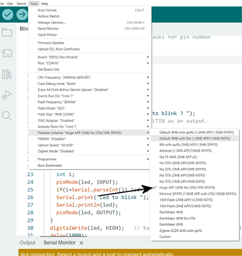

try changing the Tools>Board ESP32 Partition Scheme to "Huge App", e.g.
It works! Thank you.
