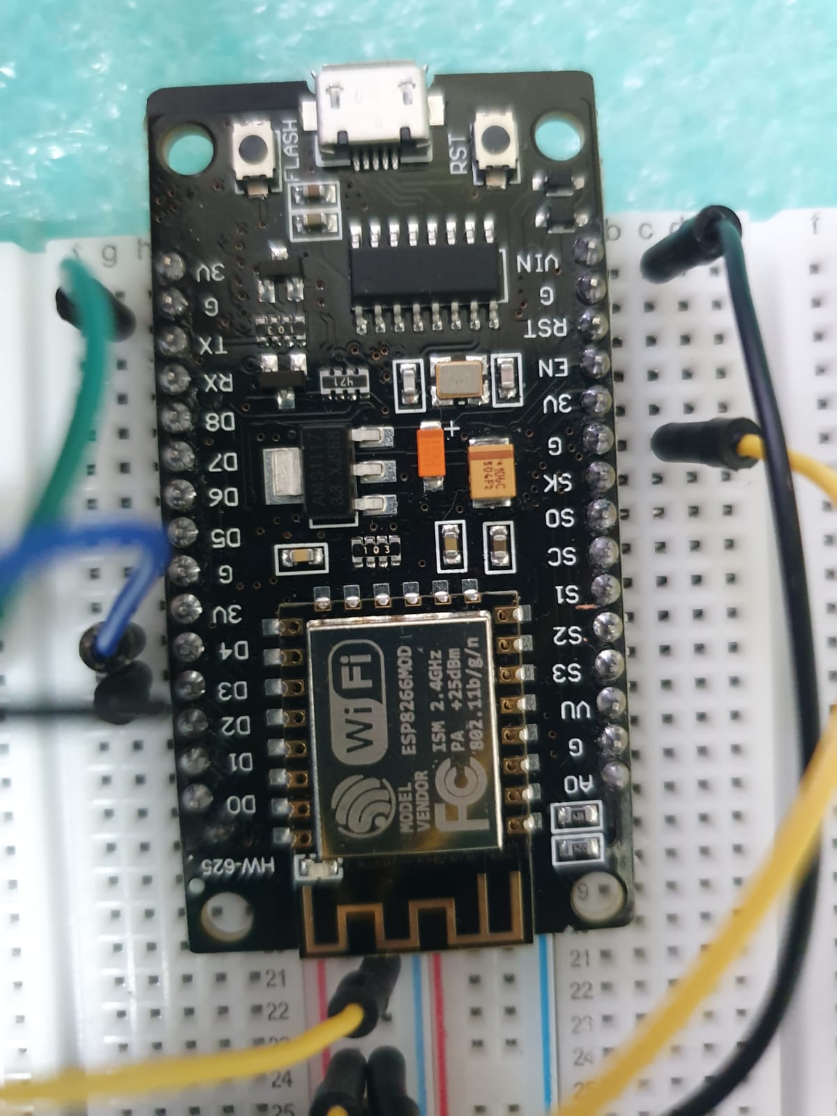

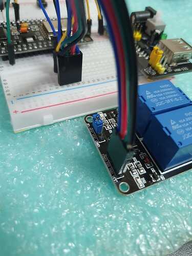

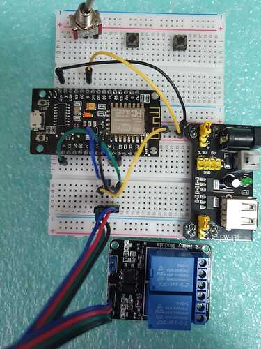

I finally got it working. All I did was changed to Pin 6,7 and in the code changed it to D6, D7. Code seems to be working now. I did not have to use any transistors. I load the code via USB and then unplug and power everything using external power supply. My power supply is set to 5v and feeds relays and the ESP board.
I can trigger relays with voice commands using Alexa. The only item remaining is to add a momentary button to manually trigger relay in case Alexa is on holidays. I have added a momentary button to pin D5 and attached the other side of the button to the ground rail. However, it does not seem to be triggering the relay.
Unfortunately, I have gone over code multiple times without much success. Could someone please give me some pointers?
Thank you for all your help.
