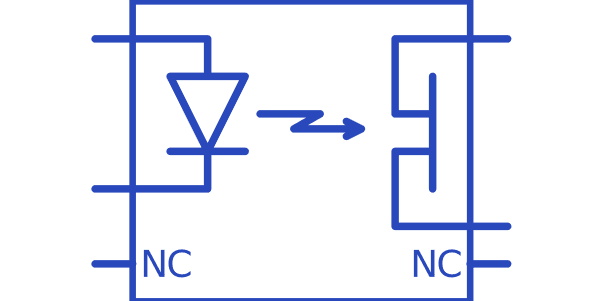

You could use an opto FET.
H11F1M-ND ~100Ω to 300MΩ
https://www.mouser.ca/ProductDetail/ON-Semiconductor-Fairchild/H11F1M?qs=k1OHqHwubKecUnq%252b3c5dew==

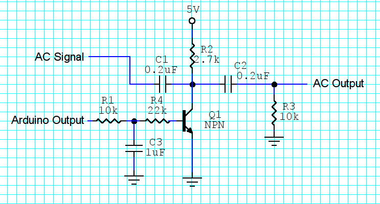

It is possible to control your signal with a bipolar transistor, but it will probably inject "clicks" into your audio signal when you turn it on and off, and it will attenuate your pickup signals even when they are turned "on". The scheme roughly might look like this:
Another better approach though might be to let your Arduino "fade" your signal, rather than turning it on and off abruptly. You can accomplish this with a "digitally controlled potentiometer" like this one.. These chips are available from places like ebay for about $1.00. They're also available in an Arduino-friendly module form.

You may have something in particular in mind here MarkT but I think it would benefit from some clarification. I may be misunderstanding you.
In general, you don't need a negative supply to process AC signals unless the signal spectrum contains important low-frequency components that make the use of capacitive coupling impractical.
In the sketch I provided in my earlier post here, the AC input and AC output in the steady state will both vary around the ground reference. When the transistor is OFF, you can see that you have what amounts to a high-pass filter between the AC Input and AC Output terminals. When the transistor is ON, the junction of C1 and C2 will be at about 0.3V DC -- but at ground potential as far as the AC Input signal is concerned (the transistor is acting like a voltage source in that state).
Over the audio spectrum, you should be able to choose reasonable C1 and C2 values to make the high-pass filter issue unimportant in this application. The big problem though, is that when the transistor switches between its ON and OFF states, the circuit will generate significant transient spikes. That's why I recommended "fading" rather than any simple ON/OFF approach. Audible clicks and pops may accompany ON/OFF switching pretty much regardless of how the switch is implemented, depending on the guitar and the amplifier it's connected to.

ps the circuit in post #2 will inject a dirty great 5v spike into the signal during switching. Not a good idea.
