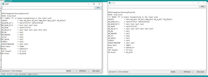

I have been trying to make it work for days, but I cant. It looks like the arduino is connecting well with the modules, but are cant figure out why they are not communicating each other.
Each one is connected in port, here are the radio.print():
Please download it, url not working.
Are the adress wrong?

Here is the output for the diagnostic code:
Obs.: I am using Antena+Nrf24+Adpter
5V
TX:
STATUS		 = 0x0e RX_DR=0 TX_DS=0 MAX_RT=0 RX_P_NO=7 TX_FULL=0
RX_ADDR_P0-1	 = 0x4141417852 0x4141417852
RX_ADDR_P2-5	 = 0xc3 0xc4 0xc5 0xc6
TX_ADDR		 = 0x4141417852
RX_PW_P0-6	 = 0x20 0x20 0x00 0x00 0x00 0x00
EN_AA		 = 0x00
EN_RXADDR	 = 0x02
RF_CH		 = 0x4c
RF_SETUP	 = 0x23
CONFIG		 = 0x0f
DYNPD/FEATURE	 = 0x00 0x00
Data Rate	 = 250KBPS
Model		 = nRF24L01+
CRC Length	 = 16 bits
PA Power	 = PA_LOW
RX
RX_ADDR_P0-1	 = 0xe7e7e7e7e7 0x4141417852
TX_ADDR		 = 0xe7e7e7e7e7
RX_PW_P0-6	 = 0x00 0x20 0x00 0x00 0x00 0x00
EN_AA		 = 0x00
EN_RXADDR	 = 0x02
RF_CH		 = 0x4c
RF_SETUP	 = 0x23
CONFIG		 = 0x0f
Data Rate	 = 250KBPS
Model		 = nRF24L01+
PA Power	 = PA_LOW
Do you thnk is there something wrong between the NRF24 and Arduino?

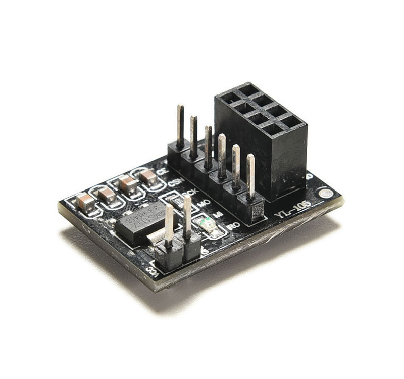

So, I made as the turorial says, here are the evidences:
Hardware: UNO + Adapater + NRF24+ + Antenna
9V battery connected to the adapter (5-12v in / 3.3v out)
Adapter MO -> Pin 11
Adapter M1 -> Pin 12
Wiring was double checked twice (four checked then kkk)

Turn off/on, connect/disconnect arduino and module, nothing changed.
Changed the module: keeps Data Sent Message 0 Tx failed

  1. Connectio Output for Module 01 (I have three)
    First one:
CheckConnection Starting
FIRST WITH THE DEFAULT ADDRESSES after power on
  Note that RF24 does NOT reset when Arduino resets - only when power is removed
  If the numbers are mostly 0x00 or 0xff it means that the Arduino is not
     communicating with the nRF24
STATUS		 = 0x00 RX_DR=0 TX_DS=0 MAX_RT=0 RX_P_NO=0 TX_FULL=0
RX_ADDR_P0-1	 = 0x0000000000 0x0000000000
RX_ADDR_P2-5	 = 0x00 0x00 0x00 0x00
TX_ADDR		 = 0x0000000000
RX_PW_P0-6	 = 0x00 0x00 0x00 0x00 0x00 0x00
EN_AA		 = 0x00
EN_RXADDR	 = 0x00
RF_CH		 = 0x00
RF_SETUP	 = 0x00
CONFIG		 = 0x00
Data Rate	 = 1MBPS
Model		 = nRF24L01
CRC Length	 = Disabled
PA Power	 = PA_MIN
AND NOW WITH ADDRESS AAAxR  0x41 41 41 78 52   ON P1
 and 250KBPS data rate
EN_AA		 = 0x00
EN_RXADDR	 = 0x00
RF_CH		 = 0x00
RF_SETUP	 = 0x00
CONFIG		 = 0x00
Data Rate	 = 1MBPS
Model		 = nRF24L01
PA Power	 = PA_MIN
As we can see - it is not connected, but for our surprise the other two modules geve us the folling output:
Module 02
EN_AA		 = 0x3f
EN_RXADDR	 = 0x03
RF_CH		 = 0x4c
RF_SETUP	 = 0x07
CONFIG		 = 0x0e
Data Rate	 = 1MBPS
Model		 = nRF24L01+
PA Power	 = PA_MAX
EN_AA		 = 0x3f
EN_RXADDR	 = 0x03
RF_CH		 = 0x4c
RF_SETUP	 = 0x27
CONFIG		 = 0x0e
Data Rate	 = 250KBPS
Model		 = nRF24L01+
PA Power	 = PA_MAX
Module 03
RX_ADDR_P0-1	 = 0xe7e7e7e7e7 0xc2c2c2c2c2
EN_AA		 = 0x3f
EN_RXADDR	 = 0x03
RF_CH		 = 0x4c
RF_SETUP	 = 0x07
CONFIG		 = 0x0e
Data Rate	 = 1MBPS
Model		 = nRF24L01+
PA Power	 = PA_MAX
EN_AA		 = 0x3f
EN_RXADDR	 = 0x03
RF_CH		 = 0x4c
RF_SETUP	 = 0x27
CONFIG		 = 0x0e
Data Rate	 = 250KBPS
Model		 = nRF24L01+
PA Power	 = PA_MAX
I tested the TX code with all the three modules, any of them sent any data.
So, what should I do now? Thanks for your help.
Based on the output you have provided Module1 is not talking to its Arduino.
What does this mean?
What adapter are you using?
...R
LOSIMONASSI:
That is a PA+LNA power hungry module combinded with a flimsy supply.
I would suggest a supply capable of providing more current,
like two AA cells, a single lithium cell, ..

The same as this guy: https://www.youtube.com/watch?v=57pdX6b0sfw&t=519s
I bought it thinking it would be easy like in the video lol
LOSIMONASSI:
Please just post a link to the datasheet for the device. I'm not watching 12 minutes of YouTube.
...R
That is the one I bought.
LOSIMONASSI:
It states "Current: 12.3 mA" but I have no idea what that refers to. Assuming it is the current available for the nRF24 then it is much too low - by a factor of at least 20 I reckon.
As @Whandall has suggested try powering the nRF24 with a pair of AA alkaline cells (3v) with the battery GND connected to the Arduino GND.
