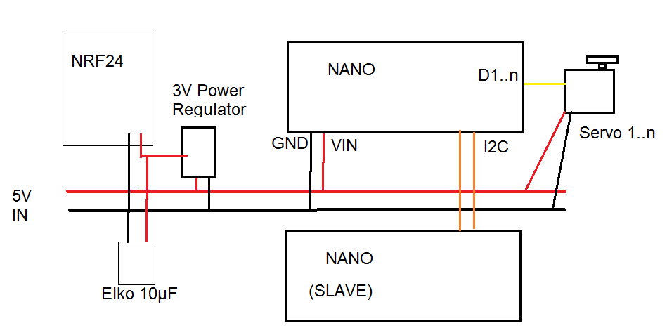

I'm using a NRF24 to communicate. The arduino is powered by an external supply and the NRF24 is powered by an 3.3V voltage regulator. Communication is stable until additional consumers (servos, arduino on i2c bus) are connected. In this case communication can't be established. Even a 10µF condensator didn't solve the problem.

Please make a simple drawing showing how everything is connected and post a photo of the drawing. Please DO NOT use Fritzing. See this Simple Image Posting Guide

That's not enough. Vin is connected to the barrel jack and the same 7v-12v recommendation applies to it. The minimum is 6v.
If you have a regulated 5v supply it should be connected to the the 5v pin.
Please, as already requested, provide a full wiring diagram.

I've the wiring attached
Image from Reply #8 so we don't have to download it. See this Simple Image Posting Guide

What is providing the 5v power? How many amps can it provide?
And see my comment in Reply #7 about Vin

Solved!
@Robin2: Thanks for your hint. It was the VIn. I changed it to V5 pin and now its working.
