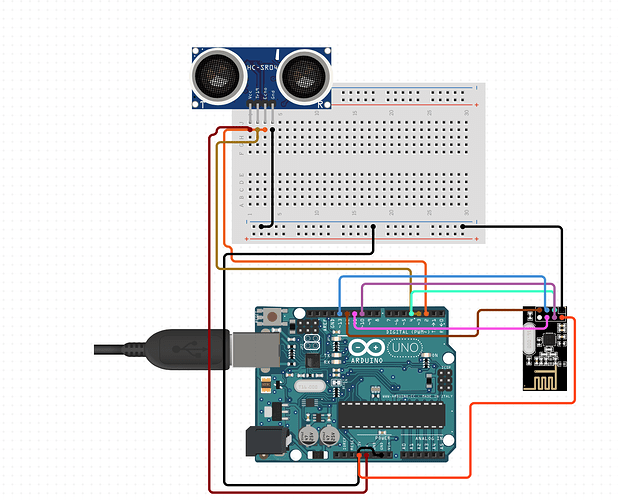

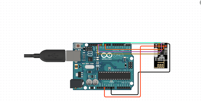

Hi everyone!
Firstly:
I am using two NRF24L01+PA with the socket to convert to from 5V to 3.3V.
In the receiver side I use an Arduino Uno and on the transmitter side I use an Arduino Uno R3.
This is the schematic for the Tx:
And this is for the Rx:
Please note that the CE pin in the schematic is connected to the Arduino Uno PIN number 4 whilst in reality is connected to the 9th (I couldn't change sorry).
Secondly:
I used the function radio.isChipConnected() on both the Tx and the Rx and it says that both are connected.
Thanks for your help.

a7
  • Powering the nRF24L01 with the Arduino 3V3 will probably not work.
    Try an external 3V3 supply that can supply the required current.
    A 220uF to 470uF capacitor on 3V3 might be helpful too.

Hi!
  • How can I get an external 3V3? Besides I'm using a module to convert the 5V to 3V3
    This is a picture of the NRF24 + socket.
