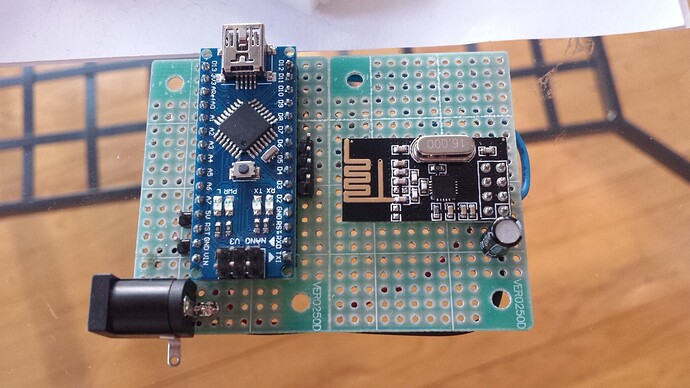

Hi all,
I am trying to setup a Nano with a NRF24L01 that talks back to a RPI (which obviously also has a NRF24L01 attached).
If I hook it up to my PC through USB or use an external 5V power supply with USB, it works.
However, if I hook up a 12V power supply through VIN, the wireless receiver appears to be getting a lot of "noise" (not sure if this is the right term). On USB, the serial monitor shows me exactly what I send off the RPI. If I connect 12V to VIN, it immediately starts throwing out carriage returns in an endless loop as if it was receiving tons of carriage returns.
// inside the loop
if (radio.available())
    radio.read(&rcv,sizeof(rcv));
   Serial.println(rcv);
As you can see on the picture, I do have a 10uF across VCC and Ground on the NRF24L01.
Any idea on what I might be doing wrong here? If you need additional information from my end, please let me know.
Thanks.
The 5v0 and/or the 3v3 regulator is probably shutting down from overtemp. The 3v3 is marginal at 5v0 when feeding an nRF24. Use a separate supply for the nRF24 in all cases.
Thanks for the advice. I will give that a try.
