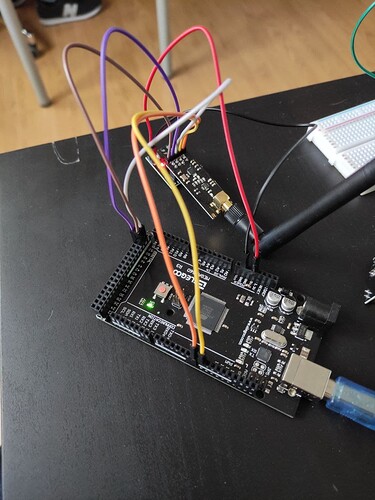

Hello everybody, I have been working on this issues for days, but I can't seem to solve it in any way. I want to simply connect two arduinos via radio communication, using the nrf24l01 module. This worked a couple weeks ago, but now it somehow looks impossible.
I have tried:
-4 different nrf24l01 modules
-4 different arduinos (3 mega, 1 Uno)
-I have checked every jumper individually
And I have had no success whatsoever.
I am using the codes from this tutorial: Simple nRF24L01+ 2.4GHz transceiver demo - Exhibition / Gallery - Arduino Forum
I used the "CheckConnections" code, and everything looks fine from the results. However, if I try the "SimpleTx" code all I get is: "Data Sent Message 0 Tx failed".
I am really clueless. Is it possible that all 4 modules are not working? This seems unlikely to me. Any help would really be appreciated.
Something strange I noticed is that sometimes I get the "Acknowledge received" message if I disconnect the CE or CSN pin, but maybe this is just an artifact and nothing gets actually transmitted (indeed I don't see anything at the receiving end).

Finally, here is the photo of the setup (very basic, actually)
You appear to have changed the pins compared to my Tutorial. When you are having trouble make sure that your test is EXACTLY the same as the tutorial examples.
Your photo shows you using a high-power nRF24 (with external antenna). If you have a pair of the low power modules (with PCB antenna) I suggest you start with them. The code will be identical.
If you only have the high-power modules I suggest you separate them by about 3 metres in case the high power is overwhelming the receiver.
How are you powering the nRF24s? Lack of sufficient current can be a problem. I suggest you try powering them with a pair of AA alkaline cells (3v) for initial testing.
Please post an example of the output from the connection test program.
You have told us the output from your Tx program. What is the corresponding output from the Rx program?

Thank you very much for the answer, Robin.
You raised very interesting points, however I don't think they are the fundamental issue here. Indeed, I have tried the same identical setup some weeks ago, with two high power modules connected to my computer, and it worked smoothly. I just set the transmission power to the minimum to lower the requirements. Unfortunately, I only have these high power modules available, so I can't try the other ones.
Furthermore, the transmission fails even if I have only one Arduino connected (so I try transmitting without receiving).
As for the SimpleRx program, there is no output at all.
This is instead the output of the "CheckConnection" code.

The connection tests seem OK.
There should at least be a start up message from the Rx Arduino.
Can you describe this in more detail
And tell us what is different between that test and the present situation.

The only output from the SimpleRx code is "SimpleRx Starting".
The only thing that changed from the test that worked are the boards that I am using and the radio modules. However, as I stated in the opening post, I tried multiple Arduinos and multiple modules, so it would seem unlikely that none of the combination works.
Other than that, I just updated the Arduino IDE and installed some libraries (unrelated to this module)

You must understand that that means nothing to me.
It does not say what boards were used when the thing worked or what radio modules and how those differ from what you are trying now.
Also your Reply #2 said "with two high power modules connected to my computer," but you have not told us how they were connected to your computer.
